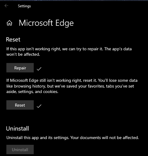

I originally installed the new Microsoft Edge in November 2019.  Beginning today, upon opening Microsoft Edge I got the message
"Windows cannot find 'C:\Program Files (x86)\Microsoft\Edge\Application\msedge.exe'.  Make sure you typed the name correctly, and then try again."
I'm not aware of any updates since I usually handle those myself.
First, I removed the desktop, start, and taskbar shortcuts.  Then I uninstalled Microsoft Edge from Programs and Features/add or remove programs and reinstalled it from https://www.microsoft.com/en-us/edge using a standard (not custom) install using both Chrome and Firefox.  I now have MicrosoftEdgeSetup.exe, MicrosoftEdgeSetup(1).exe, and MicrosoftEdgeSetup(2).exe.  I have used all three.
This did not fix the problem.  Interestingly enough, I can navigate to that location but my system can't.  No changes were made on my part to deny access to this file path.
Utilizing "repair" and "reset" in the Apps Settings has not fixed the problem.
What's going on?

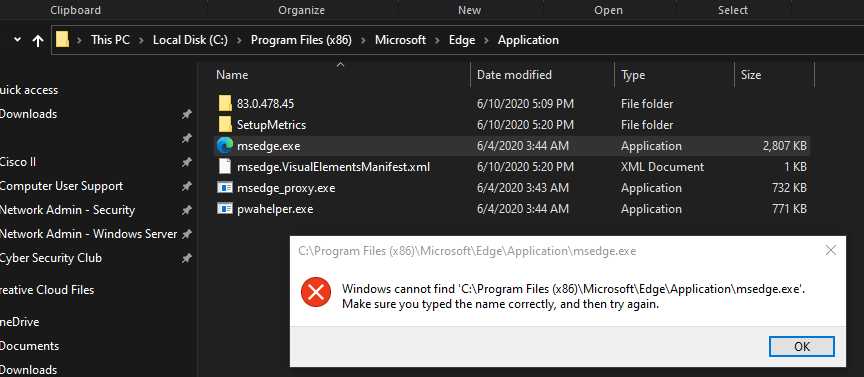

    BryanRhodes2,
    I have the exact same problem as you, i have tried everything and nothing seems to work. Very frustrating when i too have made no changes from my end for this to happen. Hopefully we can both get an answer soon.
    2020-06-10T23:38:38+00:00
    Security settings are standard.  The path from the start menu shortcut isnt the issue - it points directly to the exe file.
    Running the exe from its location in Program Files (x86) file path results in the same message.
    It's almost as if windows can no longer access that section of memory, even when run with admin privileges.
    This is true *even if the program is completely uninstalled and newly reinstalled.*
