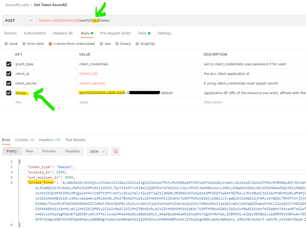

    When you are connecting via OAuth you have to specify the scope(s) you want to request. You are missing that part of the request when getting the token. It should look something like this:
    --form 'scope=Files.Read.All'
    The above, when used when you request your bearer token, will request that the returned token have the given scope. When the token is subsequently passed to the API endpoint the endpoint will confirm that the token was granted the required scope before allowing the request.

    The scopes are probably in the returned data but the bearer token is generally encrypted so what it contains is up to the OAuth server. It is important to note that claims and scopes are not the same thing. Scope is a request for a permission (and therefore the permission needed to call a particular endpoint) whereas claims are properties of the user such as their email address, phone number, etc.
    Having said all that I looked at calling OneDrive with client credentials and it mentions setting up an app and getting admin consent which I assume you did. However in the actual section 4 to get an access token it mentions you need to use the application ID URL for the scope. So refer to this example and make sure you're requesting the correct scope. I assume that this scope (a URL) then gives OneDrive access to the app's permissions (scopes).
