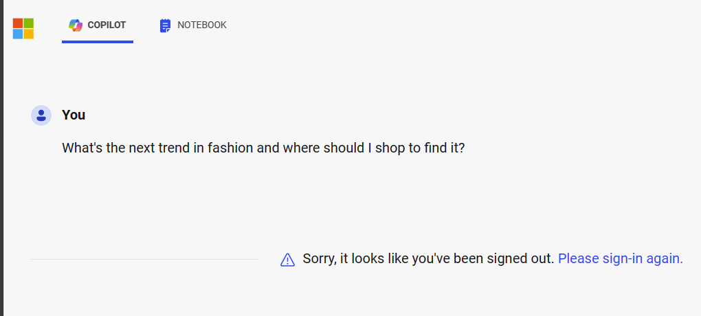

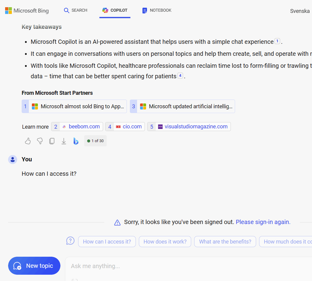

The issue is quite straight forward, Microsoft Copilot doesn't work for me.
  • Not in Edge as the plug-in
  • Not at copilot.microsoft.com
  • Not with Bing search,
  • Not with downloading the android phone app.
Tried on 2 computer, 2 phones, 1 tablet. EVERY other AI is working fine (chatgpt, gemini, etc etc etc) , no problem what so ever.
If I go outside my wifi settings, it works as it should be. So clearly it is a router / wifi setting that I need to change. There is no parental block or what not, with the mesh router Deco X20. This means that Copilot is CLEARLY doing something else which my router settings doesn't like.
But ofc finding the information of WHAT you need to allow for this app to work feels like impossible to find. Do anyone else experienced this problem and/or know what settings should be on the router?
