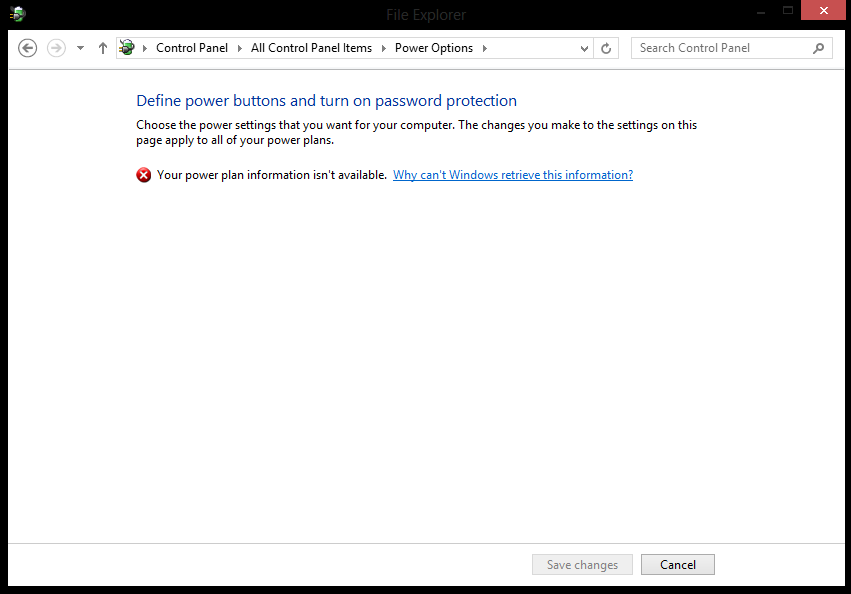

    I just noticed when I uninstall and install an updated version of my video card drivers another problem seems to appear. All of my power plans (balanced, high-performance, power saver) are gone. Can you teach me how to restore these power plans?
    Also, when I browse through my power options such as, Choose what the power button does, what closing the lid does etc., all of the options say that "Your power plan information isn't available"
    Your help will be very much appreciated. Thank you!
