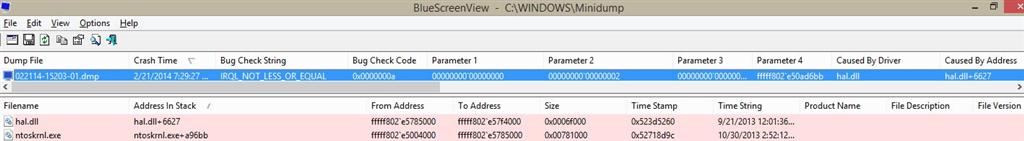

My computer will blue screen with IRQL_NOT_LESS_OR_EQUAL every time I manually restart it. The blue screen occurs after I begin the restart process (but before it goes to BIOS and starts windows up again.) It then restarts "ungracefully" after the bluescreen and goes to BIOS... etc.
I have not recently installed any new hardware. My computer is a Gateway LX4710-01 desktop. I did add in new RAM chips at one point, but the blue screens were not happening while I was on Windows 8.0. They have only been happening in 8.1 (so I don't think the RAM upgrade is the issue.)
I would appreciate knowing what I need to do to stop these blue screens from occurring. I have been reading how other people have been able to resolve this and would prefer not to remove/re-install ALL drivers if it can be helped - maybe the dump file can provide specific information. What can I do to pinpoint the specific problem, and then resolve it?
This is the link to the minidump file:
https://onedrive.live.com/redir?resid=7CF80F36DFE197C9!289&authkey=!AEVM3i0AxoelT6E&ithint=file%2c.dmp
I opened the file in BlueScreenView and two lines are highlighted in red, one is for hal.dll and the other is for ntoskrnl.exe:

Hi Richard,
The attached DMP file is of the IRQL_NOT_LESS_OR_EQUAL (a) bug check.
This indicates that Microsoft Windows or a kernel-mode driver accessed paged memory at DISPATCH_LEVEL or above.
This bug check is issued if paged memory (or invalid memory) is accessed when the IRQL is too high. The error that generates this bug check usually occurs after the installation of a faulty device driver, system service, or BIOS.
We have very little to no info in this dump, for example:
1: kd> kv
Child-SP          RetAddr           : Args to Child                                                           : Call Site
ffffd00020d0f7c8 fffff802e515d7e9 : 000000000000000a 0000000000000000 0000000000000002 0000000000000000 : nt!KeBugCheckEx
ffffd00020d0f7d0 0000000000000000 : 0000000000000000 0000000000000000 0000000000000000 0000000000000000 : nt!KiBugCheckDispatch+0x69
^^ Nothing in the call stack except nt!KeBugCheckEx being called.
Some detective work will be necessary:
1. Please uninstall Acronis True Image as the device drivers are too old to function with Windows 8, also it generally causes conflicts.
2. Uninstall your Realtek card reader software, or check for an update (likely not available) - http://www.realtek.com.tw/downloads/downloadsView.aspx?Langid=1&PNid=15&PFid=25&Level=4&Conn=3&DownTypeID=3&GetDown=false

    Hi Patrick,
    It seems that the problem was the driver with the Realtek card reader. Oddly, the program to install the new driver (at the link you pointed me to) went through the motions of installing, and ended with "installed successfully" at the end of the wizard, but Windows device manager still indicated that the driver was the old version. Luckily, I was able to select what I guess is the newest working driver (although I'm not entirely sure if it's the 'correct' one) by installing through device manager's manual "have disk..." option. and picking drvbin64\RtsBaStorMSI.inf and then the USB 2.0 driver 6.3.9600.39057.
