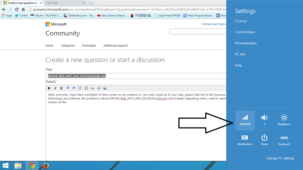

Hello everyone. i have have a problem of blue screen on my windows 8.1 pro and i need all of your help. please help me fix this because i am not good in technology and software. the problem is about DRIVER_IRQL_NOT_LESS_OR_EQUAL(ndis.sys) and it keeps happening when i want to open the wireless section on the setting section.
hopefully someone can help me!
