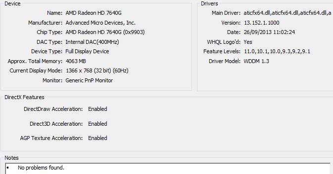

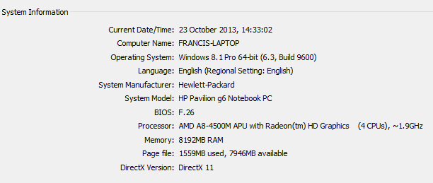

    I'm Using AMD Radeon HD 7640G, AMD A8 4500 Quad Core Processor, I was uploading the dump, I'll give you a link once' I've sorted it out.
    https://skydrive.live.com/redir?resid=DAD8F8A659A61E33!14545&authkey=!AHX_UFhlZ0558hc
    Please tell me you're verdict on how to fix this issues.
