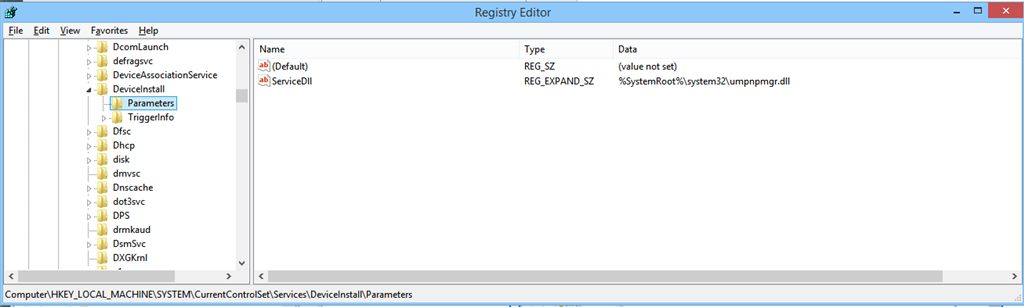

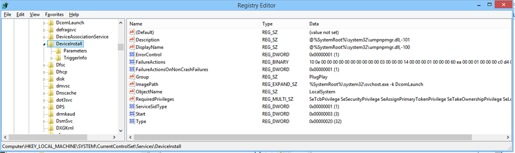

    The DeviceInstallDisabled reg entry does not exist. Here is the deviceinstall key:
    And here are the parameters:
