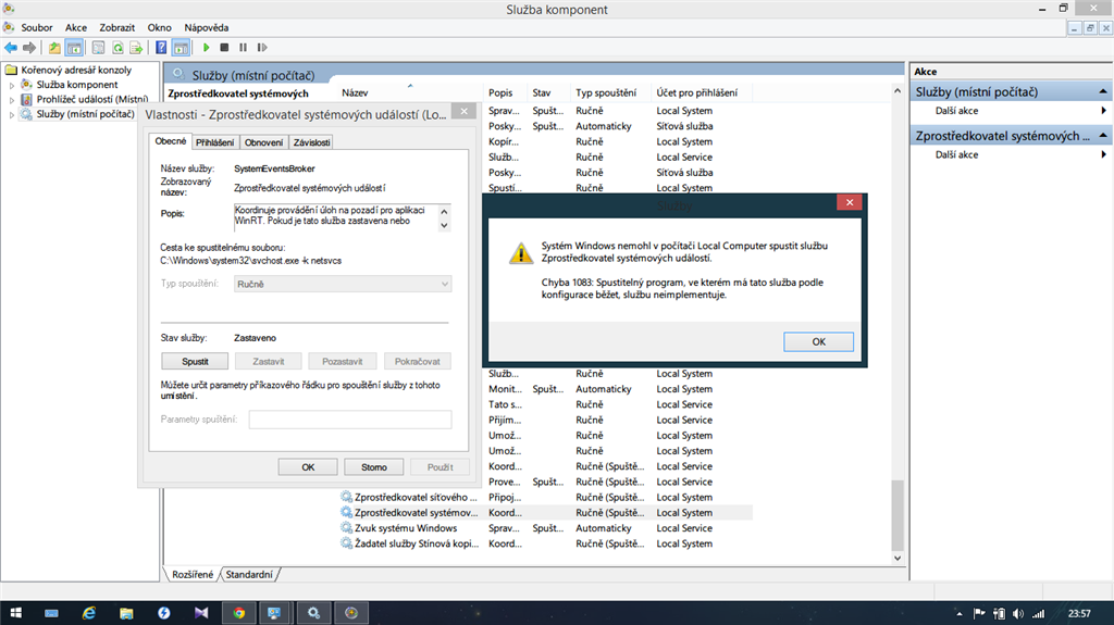

    Thanks a lot for this, but i have another problem with this :)...I can´t change the startup type. It´s still set on Manual.
    And when i choose Run, give me error 1083.
    Sorry for czech lang in screen,
    Thanks for your help

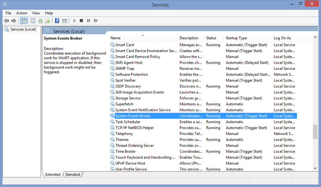

    2014-01-13T00:58:39+00:00
    Hi Mira,
    Turn off and turn on the System Events Broker service and check.
    a.      Press Windows and R keys together.
    b.      Type in Services.msc and press enter.
    **c.**Scroll down and select System Events Broker. Check whether it is started.
    d.       Double-click the service and its properties window will appear.
    e.      Click stop to turn off the.
    f.        Click on Start to turn on the service and check.
    2014-01-13T09:49:40+00:00
    HI,
    I can´t turn off or turn on.
    There is only available RUN, but when choose Run give me "error 1083:executable program that this service is configured to run in does not implement the service".
    Thanks
