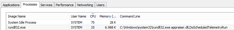

Since faithfully installing the Feb 2015 updates, I have found the next day that rundll.exe is constantly using 12.5% of my CPU (equivalent to a whole CPU on an i7 chip). On investigating the command line in Task Manager it shows that rundll.exe is running "appraiser.dll DoScheduledTelemetryRun".
With some web investigation I find that the dll is published by  Microsoft and is called a Compatibility Appraiser for Windows 10. Is this correct? I can't find where I originally got that information. Since my computer was going crazy and appraiser.dll was interfering with the operation of other applications (ones that I actually wanted and needed to use), the fans are running at full speed to keep my CPU temp under 70 degrees celsius.

    Ok so I found this Microsoft Compatibility Appraiser in Task Scheduler and its description is "Collects program telemetry information if opted-in to the Microsoft Customer Experience Improvement Program"
    So clearly I need to Opt Out.
    I have stopped the task running. Ahh the fans have slowed down now. I have disabled the Task. I have also disabled the AitAgent and ProgramDataUpdater.

    Interesting, I would say it is more a pest. I suspect Microsoft has released errant code when updating appraiser.dll in order to collect compatibility data for Windows 10 and that AVG has picked up that it is gobbling lots of resources.
    I simply opted out of the Customer Experience Improvement Program in order to improve my experience of Windows 7.

    Same thing here with my quad-core:

    I have the same problem with "rundll32.exe appraiser.dll,DoScheduledTelemetryRun" hogging one thread to 100%.
    I do remember opting in to the customer experience improvement program, and I believe that's when it started happening (intermittently).
    I now chose to opt out from:
    Control Panel\System and Security\Action Center\Change Action Center settings
    but it is still happening...
    Suggestions?
