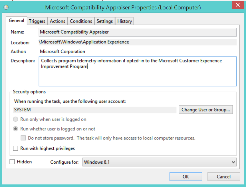

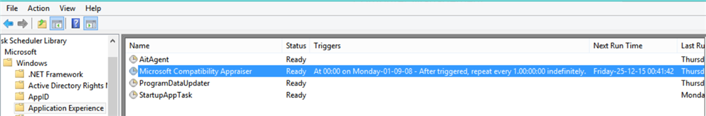

    Yet when I opened Task Scheduler ---> Task Scheduler Library ---> Microsoft ---> Windows ---> Application Experience, I was horrified to find that my opt-out has been ignored completely from day one and everything I've been doing on the machine is (or was) being relayed to Microsoft. Here's a screenshot I took before deleting the tasks.
    So it seems my wishes to opt-out of the CEIP were being completely ignored.
    I've taken appropriate steps now to ensure that it doesn't run anymore, but I've extremely annoyed that Microsoft simply ignored my wishes not to participate in the CEIP.
