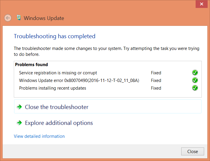

Any attempt to run windows update is met with failure; it just gets stuck on 'checking for updates'. If I use the troubleshooter it says 'no updates available.' Now if I try to run 'check for updates' on windows defender after the first try, it gets stuck on about 20% of searching.

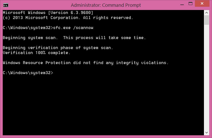

SFC shows no errors.
The results of running the troubleshooter after the *factory reset*
