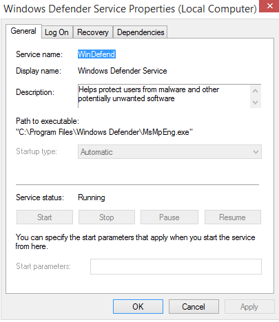

    Turns out I didn't disable windows defender like I thought I did- I went into the actual program and turned off real-time protection, but discovered it was still running in task manager 'services' today
    I right-clicked it and pressed stop, but I got 'the operation could not be completed- access denied.'
    I think this might be the sole program causing my disk to run at %100, but I can't disable it.
    I also tried going through this route: Control Panel-> System and Security-> Administrative Tools-> Services-> and double-clicked Windows Defender Service. The option I need to click to disable is there, but it's all grayed out. (It also confirms it's still running next to 'service status')
    I need to click from 'automatic' to 'disable' but I can't. If I could access these grayed out options, I can see if it's really Windows Defender causing my disk to run at %100. I think this might be what's causing it but I can't access options to disable.
    I figured I needed admin permissions to access them. I am the admin account though, and I also tried right-clicking 'run as administrator' on Services but the options are still grayed. I opened Services properties tabs and then the security tab, then clicked 'edit permissions' but I can't check the 'special permissions' box becuse it's grayed out too.
