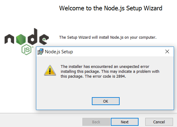

    2017-07-16T00:47:30+00:00
    I've just tried Safe Mode and a Clean Boot. The issues still occurs.
    This is the dll error I get for trying to start GIMP image software.
    This is the error I get when I try to install Node.js.
    This is the error I automatically get when I have my js file open in Visual Studio Code.
    The More Information button option brings up this page: https://code.visualstudio.com/docs/languages/javascript#\_automatic-type-acquisition
    This is the error it throws when I try running the Node.js debugger on Visual Studio Code. The js script works fine since I'm currently running it on another device.
