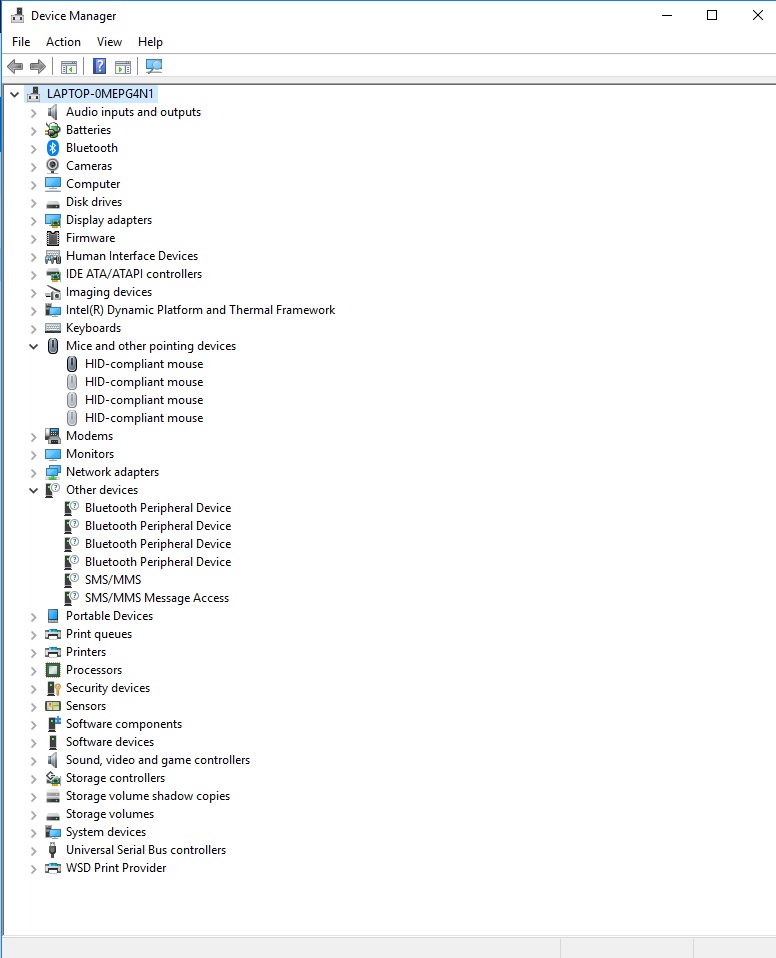

    2018-02-05T20:09:28+00:00
    Hello
    Here is a screenshot of my device manager.
    As you can see, there is nothing under 'Other Devices', or under 'Mouse and other pointing devices'.
    The driver I need should be called 'Asus PTP' (Precision Touch Pad), but there is nothing in the Device Manager.
    Regards
    Stephanie

    2018-02-06T23:02:30+00:00
    Thank you for the screenshot, Steph. The Asus PTP' (Precision Touch Pad) should be under the Mouse and other pointing devices. Since it's not there, please try to scan for hardware changes. On your Device Manager, click Action on the top and select Scan for hardware changes. Try also to press Fn + F9 keys and see if the touchpad will appear.
    If this doesn't work, then go to Settings > Update & Security > Windows Update and click Check for updates.
    Please update this thread with the result.
    Regards.
