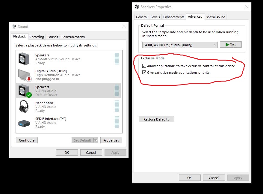

  • Swapping headsets
  • Going to the Playback devices, speaker Properties menu and turning off all Enhancements

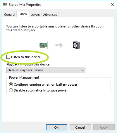

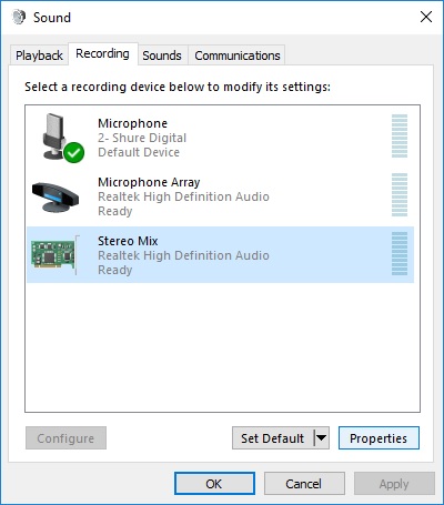

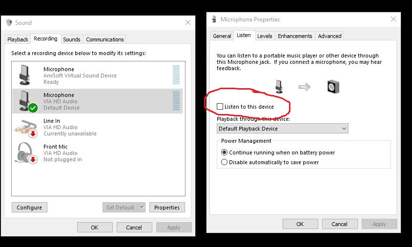

My issue was in the Recording devices menu. The shortcut to this menu is to right click on the speaker icon in the task bar and click on the Recording devices tab. **** Once in that menu, select the Stereo Mix device and click Properties.
Once in the Properties menu, click on the Listen tab and make sure the option Listen to this device is not checked.
I did this prior to reinstalling drivers or restoring, but I did try the other suggestions. I don't know how common this particular problem is, but this solution worked for me.

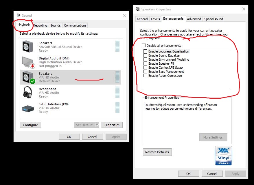

    select the playback tab>>select speakers>>Properties>>Enhancements
    some of these will make echo sounds and such, disable them

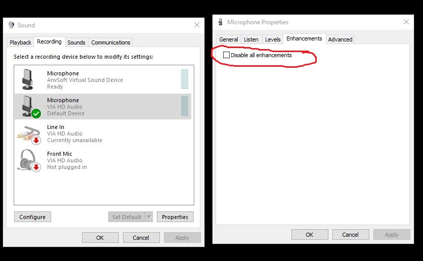

    select the recording as you have shown, then select the MIC not that stereo mix that is for recording and then select properties and configure your MIC like Disable it if need be
    Now I believe that there is stereo mix in  the playback settings also, I would like to see that. Set those for mixer in playback.
    But back to MIC, the image you show to "listen to this device" in recording, stereo mix and mic, you need to disable it and I believe your issue will be gone.

    Forgive me if I wasn't clear, but I resolved my issue using the method I posted.
    I tried your method and it didn't work for me. The issue persisted, and this was my solution. The only reason I posted this was in case someone else had the same issue, if it was resolvable with the method you're suggesting, I would've left it to the other posts I found.
    I will post an edit to the original post to show the box as unchecked, because that's what my instructions were stating. I was worried that may be confusing.

    Well bud, I do not know how it is possible to resolve feedback in the headphone on a playback device using the recording settings. I find that Impossible, especially when that setting is only for MICS  and plugged in media devices such as a MP3 player. Then no settings were shown for playback. Anyways have a good one.
    I also see that you edited it after my posts and now shows in photo, the box unchecked in yellow circle as it was checked and circled before.

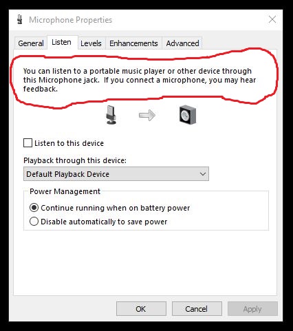

    And just to be polite,
    Recording is input, MIC, MP3 player, audio in
    Playback is output, speakers, headphones audio out
    Only if you had MIC plugged in would you possibly get feedback in the speakers or headphones. You would then just disable or unplug the MIC.
