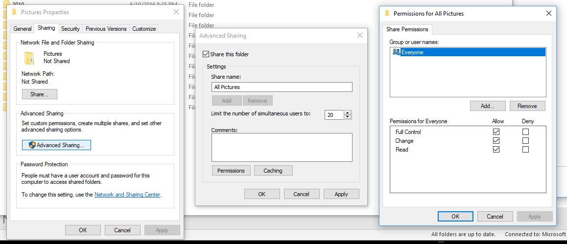

Now that HomeGroups are gone, I'm trying to share a folder between several PC's on my local network.
I've set sharing permissions in every way I know how.
Whenever I try and navigate to the folder from one of the other machines, I'm prompted for the user account, that's fine, I enter the MicrosoftAccount\___@___.___ and password credentials.
Every single time, I'm told the password is incorrect. It is 100% correct. All machines on the network are configured using the same Microsoft account, which I would have thought would have made this process quite painless.
Any idea what I'm doing wrong? I'm hoping there is something obvious I'm overlooking.

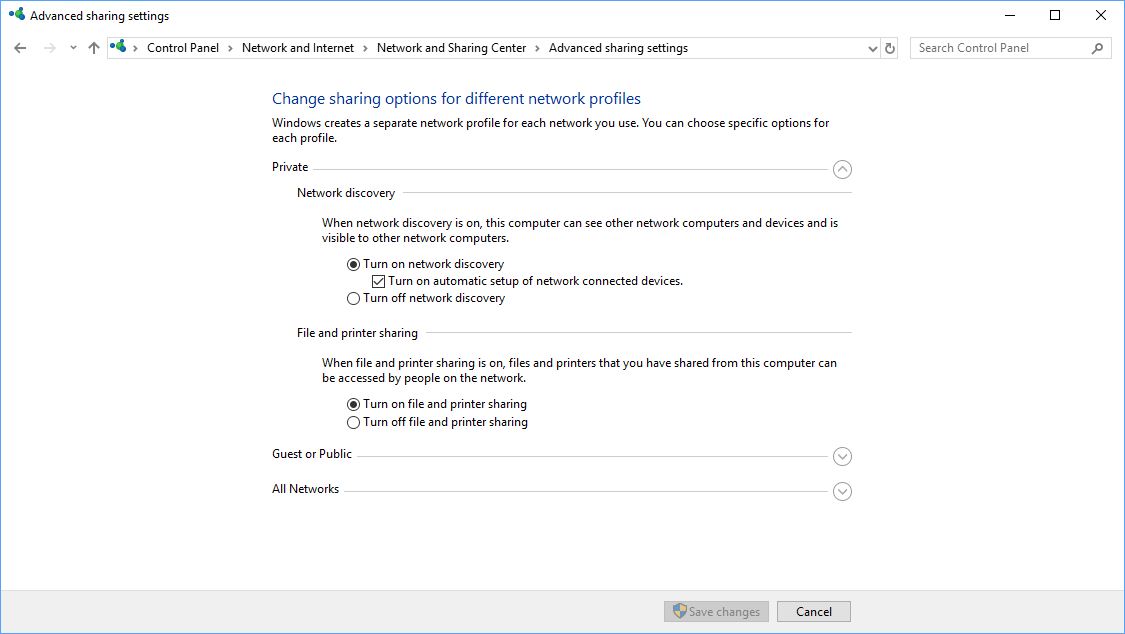

    Go to Control Panel > All Control Panel Items >Network and Sharing Center> click on Advanced sharing settings. Expand the Private section, and ensure that these three are selected:
    Turn on network discovery
    Turn on file and printer sharing
    Allow Windows to manage homegroup connections

    The build of Windows 10 I am using does not have HomeGroup. You will see this from the screenshots below.
    I do not require password security for sharing between these computers. I have tried both require password and do not require password options in the Advance sharing settings panel.
    My understanding of Microsoft Accounts is that the username belongs to the Microsoft Account domain and therefore can exist across multiple machines. Happy to be proven wrong, but the "MicrosoftAccount" indicates to the host machine that the user is a domain user rather than a local account user.
