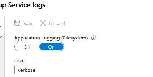

In Azure App Service Settings:
In AppService Logs:

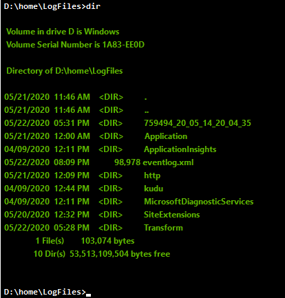

    I experienced this problem! It took me a while to figure it out, but I finally did. I deleted my old log file that was in Home/LogFiles/Application. and then it started working! I'm assuming it was some storage issue.
    Along the way, I also updated the AzureAppServices package manager and uninstalled and reeinstalled the ASP.NET Core Logging Integration extension in Azure. I don't think those contributed, but they could have.
