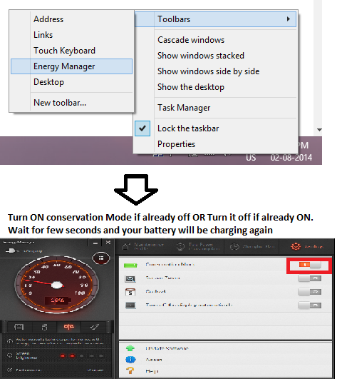

    Here is the simple fix I done</
    1. Right click on the right bottom corner of your toolbar, Select Toolbar >> Energy Meter
    2. Then Open the Energy meter
    3. If conservation mode is already OFF, turn it ON. If already ON, turn it off.
    4. Wait for a few seconds and you can see the battery started charging again.
    Check the screen Below:
