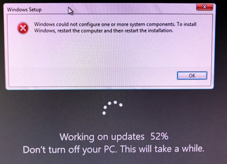

Windows 10 1809 update problem(Windows could not configure one or more system components. to install windows restart the computer with error code 0xc1900101-0x30018)
2018-10-11T06:51:19+00:00
When the update was downloaded and prepared , it called me to restart the computer to install 1809 update . However, until 52%, it said that "Windows could not configure one or more system components. to install windows restart the computer." After it restore the system, i check out the update record and find that the error code is 0xc1900101-0x30018. What should i do?

    Ischte - I could kiss you. Your suggestion worked for me!
    Rather than booting into Linux, I was able to rename the inetsrv folder to inetsrv.old in Windows by:
    1. Taking ownership of the folder
    2. Stopping the Application Host Helper Service
    I then took ownership of the WinSxS folder in order to move the *windows-iis*.* folders to a backup folder on another drive.
    With these out of the way, I then used the Windows 10 Update Assistant(rather than the ISO I had created), and updated successfully.
    When the updater reached 52% - where it would normally create the error message - it instead went back to 46% for a moment, then jumped back to 54% and continued progressing from there. I'm guessing this is where it needed to rebuild the files I had removed.
    Once the update was complete, I deleted the C:\Windows\System32\inetsrv.old folder.
    All is well, and I am successfully updated to 1809. Thanks again for your help!

    My solution:
    I also had the problem with updating Windows 10 1803 (last version) to 1809 and the standstill at 52%, then rebooting and restoring the old version. I noticed in the logfile which I analyzed the part with "iissetup.exe" in connection with the abort. shift+f10 for a console and possible repair with regedit during setup didn't work for me.
    Therefore I proceeded like this:
    In the software deinstallation (control panel) and with msicleaner (msicuu) i removed all old .net and visual studio parts. And then i reinstalled them with offline installer versions. there were still remains of old installations, but in the end they didn't solve the problem.
    Even with feature removal (control panel) and uncheck the box "internet information services" i couldn't get any further, because there were errors during deinstallation.
    The crunch point was the following:
    I booted with ubuntu linux and renamed the folder "c:\windows\system32\inetsrv" (which also contains the "iissetup.exe") e.g. to "inetsrv.old". Additionally, under "c:\windows\winsxs" I moved all folders with the name mask "*windows-iis*.*" to another location.
    Then i booted windows 10 again and restarted the update via the windows 10 update assistant.
    Now it ran error free through the installation and the files/folders under "inetsrv" and "winsxs" were rebuilt with the current version.
    Now my system is update correctly to the latest Windows 18 1809 build patch level. No further problems.
    Hope this help, Ischte
    70+ people found this answer helpful.

    I still find myself in the same boat as Lok32123; unable to update from 1803 to 1809, resulting in the same error above. Now that the update has been deemed safe to resume (except in a few cases), I'm hoping you will join me on a journey of troubleshooting.
    Caveat: while I could do a clean install to resolve the issue - I've used the Media Creation Tool to create a bootable USB with 1809 on it, just in case - I'd rather not go that route. Besides, I'm really curious to find the root cause here.
    My system:
    • Windows 10 Pro version 1803, build 17134.407.
    • All updates installed (even KB4467702) - Windows Update is squeezed dry for now.
    • Intel Core i7-8700K, 16GB RAM, 100+GB free space on the system drive (Intel SSD).
    • Discreet Nvidia graphics, wired ethernet connection, and a patridge in a pear tree.
    • No third party firewall, malware, or virus scanning software installed
    My Method:
    Since I have not been "pushed" 1809 via Windows Update, I went to get it myself from the update assistant at:
    https://www.microsoft.com/en-us/software-download/windows10
    I used the "Update Now" button, which gets you a copy of Windows10Upgrade9252.exe to download and install.
    After rebooting, this update proceeded to 52% before resulting in this screen, followed by a full rollback:
    At 52%, "Windows could not configure one or more system components. To install Windows, restart the computer and then restart the installation."
    Clicking "OK" results in a reboot and full rollback. No error code is presented once the rollback is complete, so I didn't have much to go on here.

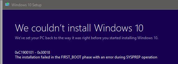

    This time I ran the update through the Media Creation Tool (using the "Update Now" option rather than creating media). Same failed result - 52%, could not configure one or more system components, full rollback. However, this time I got an error message from the utility after the rollback:
    Error 0xC1900101 - 0x30018. "The installation failed in the FIRST_BOOT phase with an error during SYSPREP operation."

    Several commands involved "iissetup.exe" failed, but the line "iissetup.exe /install SharedLibraries" resulted in the message "Failure will not be ignored: A rollback will be initiated (etc.)" A further 7 lines in the log resulted in "Failure will not be ignored," all involving iissetup.exe with various different parameters specified.
    Finally, I created a bootable USB stick from the Media Creation Tool for Windows 10 v1809, disconnected the network cable, rebooted, and tried to upgrade directly from the media.
    Same exact result (full rollback to 1803), same exact errors in setupact.log.
    I did another clean boot, opened an elevated PowerShell, and directly ran some of the iissetup.exe commands (even though they are not meant to be called directly by a user), just to see if it would give me any more error information. All of them failed with code 0x8007000d, with one exception:
    "iissetup.exe /install SharedLibraries" returned 0x8009000f.
    This is where I ran into a dead end. The only reference I could find to this error was in a 10 year old threadspecific to IIS reinstallation and machine encryption keys. I tried following the recommended procedures there and re-running the update, but to no avail.
    I have a programming background, so I'm trying to "step through" the problem, but I can't seem to find any answers to what would cause the "un-ignorable" 0x8009000f. Any leads would be greatly appreciated!
