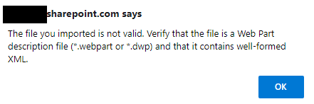

I thought, no problem. I could recreate the subsite, but I fell at the first hurdle. When I tried to set up the first web part and import the appropriate list (as per the above process), I got an error message:
I looked at the XML file and there were indeed errors in the file, at least as far as the validation tools I used were concerned. What I don't understand is that the XML code should not have changed as the SharePoint data on which the webpart file is based did not change with the migration, apart from the URL for the site. Did the migration change something that I cannot see in the file? I did not save the XML code from before the migration, so have nothing to compare it with.

    This is may due to the deprecation and removal of the DataFormWebPart as part of MC242207.
    Message Summary
    To enhance data integrity and improve the overall reliability of the service, we are retiring support for external XSLT file references for the DataFormWebParts and its sub-classes (e.g. XsltListFormWebPart, XsltListViewWebPart).
    This retirement affects only classic SharePoint pages.
    Key points
    Timing: mid-March
    Roll-out: tenant level
    Action: review and assess before March 15, 2021
    How this affects your organization
    Support for external XSLT files references in the DataFormsWebPart and its subclasses will no longer be available after March 14, 2021.
    After March 14, 2021, the DataFormsWebPart will be unable to perform functions that rely on external XSLT code.
    If you are currently using a DataFormWebPart that references external XSLT code, you will need to modify the reference to an internal XSLT file located in the site’s asset library instead.
    Potential scenarios for using the DataFormWebParts on classic SharePoint pages:
    DataFormWebParts have been created via SharePoint Designer and include XSLT code
    DataFormWebParts have been created and customized in the browser or via PowerShell to include XSLT code
    What you need to do to prepare
    Conduct an audit of DataFormWebParts for all classic SharePoint pages that may exist in your tenant. If you discover external XSLT references, remove them.
    To retain the same functionality as before, use one of two methods:
    Copy the external XSLT files to the asset library of the same site on which the DataFormWebParts are hosted. Then reference the XSLT files from there instead.
    Consider using a modern solution such as JSLink for classic SharePoint pages, and SPFx or custom formatters for SharePoint modern pages and lists.
