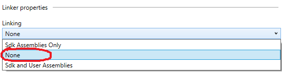

    You can try to set the linker option to None and try again , just as follows:
    For more details , you can check Linking on Android.
