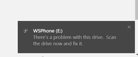

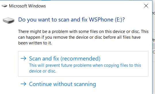

    Also when I first plug it into the computer, I get this error.

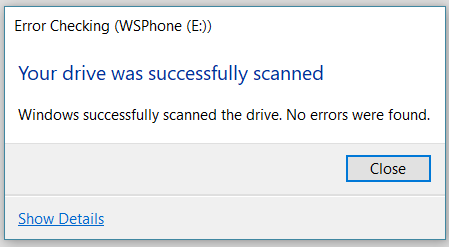

    However, when I try to scan and fix
    I get this result
    Which leads to this

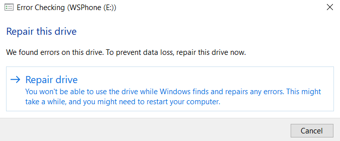

    But then, once I click close, another window opens (see photo before last) that says repair this drive, and every time I go through it, it just continues the pattern, so I'm not sure what this means.
