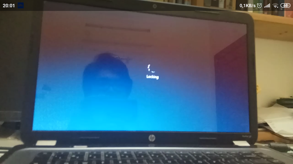

2 days ago i upgraded my windows 10 to build 1903 , since then ,
randomly and during any activity (gaming , watching a video ..etc) ,
screen with the word "locking" in the middle appears for half a second and my laptop goes into sleep mode
and then i have to turn it on again
this never happened before the update , i tried to reset and fresh start but, nothing worked , and now i can't get back to previous build
what do i do ?
HELP , PLEASE

    I believed you are asking for the picture of this screen? Sorry for the blurry image because this screen appeared really fast like half a sec so I have to record with my phone and cut it out from the clip. But this is technically what happened to me and everyone.
    I'm sorry but it's a little strange to see even a Windows MVP like you haven't seen this screen before.
