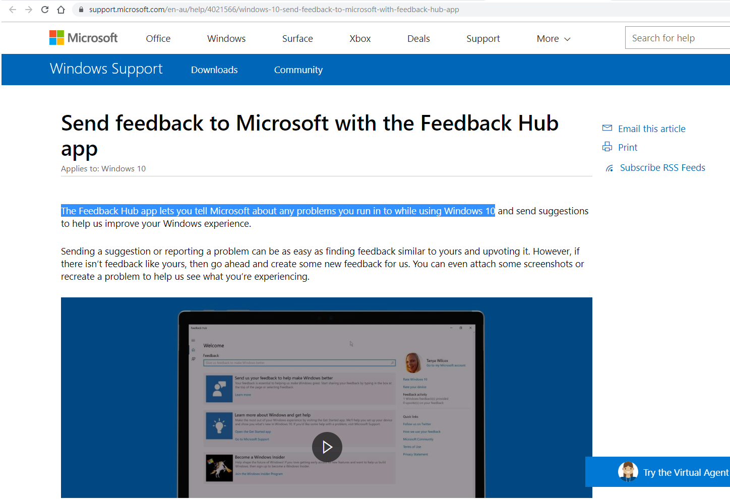

    You can report the problem and suggestion directly to Microsoft by Feedback Hub app:
    https://support.microsoft.com/en-au/help/402156...
    Anthony
    2019-09-28T18:41:17+00:00
    Thank you Anthony for furnishing the link to the Microsoft by Feedback Hub app.
