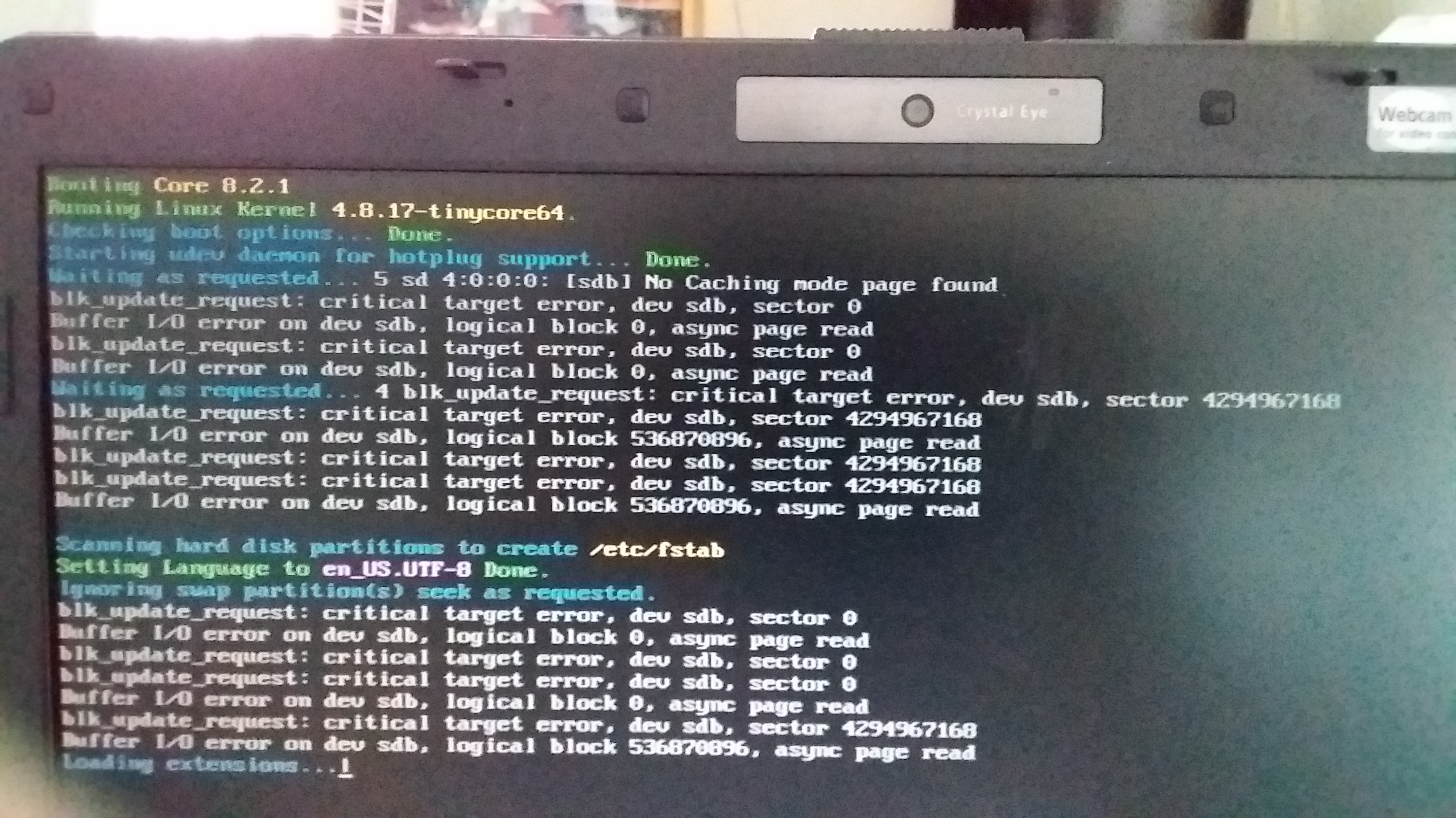

    Originally  file explorer could detect my ext. harddisk and detected no errors when I did a disk check but after shutting down my laptop with it still attached, it  could no longer be detected when I switch on my laptop again. In the taskbar it can recognize it as  My Book.
    Please refer to image of Seatools Dos test result of my external WD ext. harddisk.

    2019-12-05T03:24:42+00:00
    Did you back up any files from the external on a PC which could read it, or is it not read anywhere? Initializing it will destroy the data.
    What you report makes me think the drive may be bad. Run hard drive diagnostics:
    https://www.lifewire.com/free-hard-drive-testin...
    Best is to use the manufacturer's own if there is one, otherwise use Seatools bootable long test: http://blog.nowherelan.com/2013/04/04/boot-seat...
    If it passes wipe the drive with Clean Command and reformat in Disk Mgmt:
    https://www.tenforums.com/tutorials/85819-erase...
    http://www.wikihow.com/Format-an-External-Hard-...
