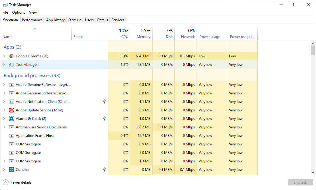

    Thank you; knowing that calling SystemPropertiesPerformance opens that window makes customisation much easier for me.
    However, I specified that I wanted the thumbnails on .EXE files to also be removed, for I already knew what the above steps did. Is there a way?
    I'm just demonstrating what I mean by thumbnails for executables.
