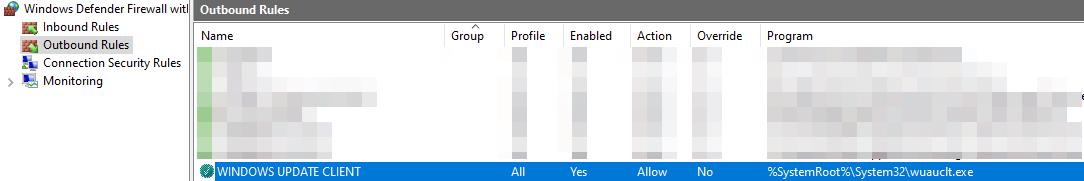

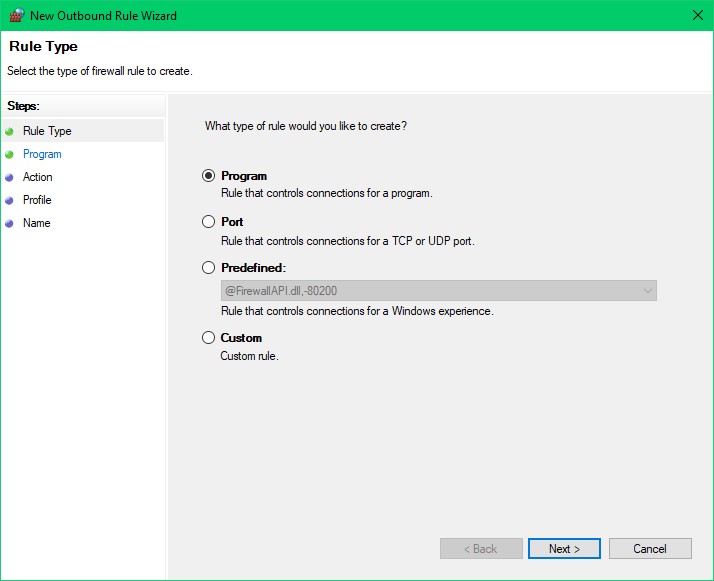

    I created a new rule in Outbound Rules while blocking everything as above

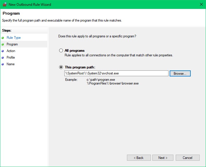

    saying to allow
    %SystemRoot%\System32\svchost.exe
    i think it's the same as
    C:\Windows\System32\svchost.exe (please confirm)

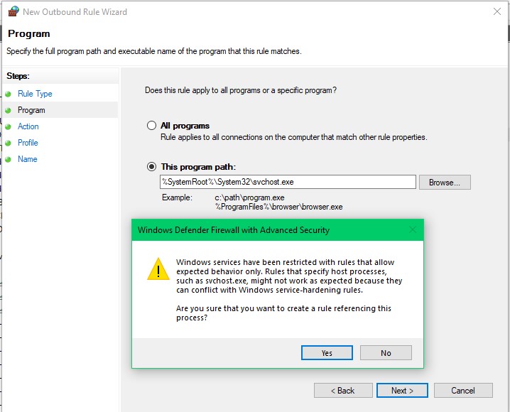

    and then it showed me this warning and anyway i clicked OK > NEXT
    and there it is. . it's updating.
    I donno whether that's the right way to do it or is there any particular svchost.exe for it. i have svchost.exe being infected in the past while i was using windows 7. so donno the correct location of svchost.exe for this windows updating. 😃

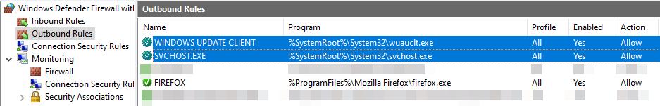

    but weirdly as soon as i allowed there was a bunch of
    Service Host : *** running in background processes which were idle before that.
    Please advice.

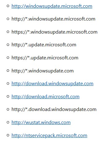

    And I donno how to add these windows update domains as suggested in one of ur solutions.
    in the rules. Windows Firewall only has Program, port, ip, custom.
    where do i add them?
