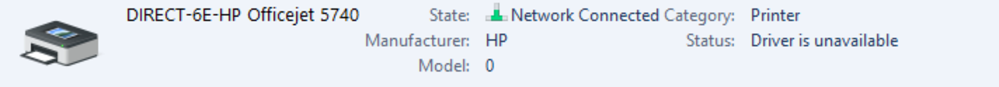

The printer appears to be connected. I can ping it from a terminal on the computer, so it seems like it's visible on the network just fine. But you can see there in the status that it says "Driver is unavailable". If I try to print something with Microsoft Word, it says that it can't connect to the printer. I have uninstalled and re-installed the drivers several times, through Windows and through HP, and I updated to the most recent version of Windows, but it still has the same problem every time.

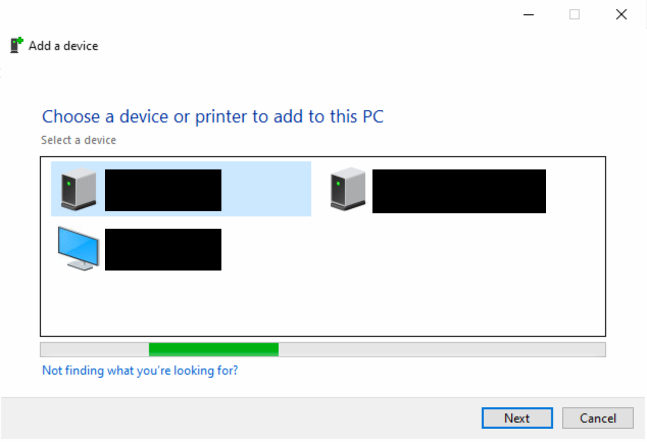

The last time I fixed this problem for them, I had to manually add the printer, the network discovery feature wasn't working. However, this manual adding seems to have been removed.
The "Not finding what you're looking for?" button just takes me to a Microsoft support page for connecting Bluetooth devices, which is completely irrelevant.
This support page says there should be a "The printer that I want isn't listed" button, and that matches with my recollection from last time, but it's gone.

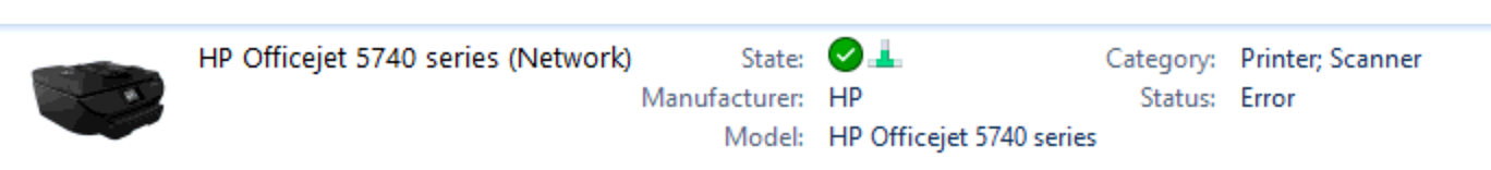

    Windows also reported that it was able to connect to the printer, which is progress from my original post.

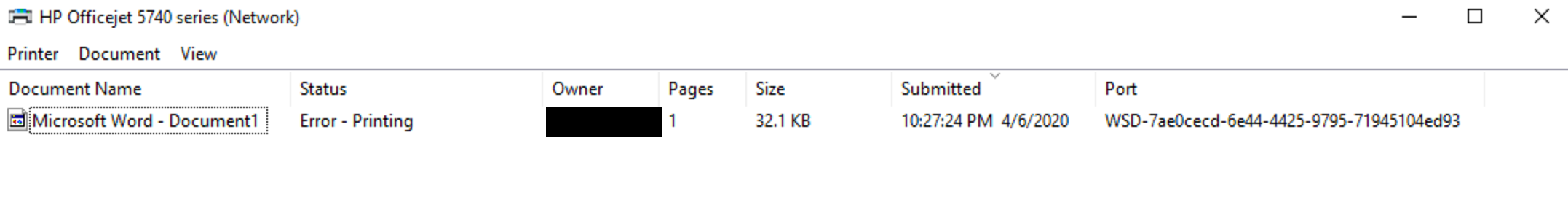

    However, after trying to print a test document, I got a new error.
    Print Queue

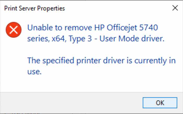

    So here I realized that I had forgot step 3. Option 1 did not work, Windows says "printmanagement.msc not found". Option 2 gave me some more interesting results, I found a bunch of old drivers from different model printers and removed those. However I was not able to remove the printer drivers for the 5742 with the following error:
    I checked again after removing the old drivers and got the same error I did last time.
