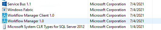

Web Platform Installer with installed components are:
Error found when install Windows Server AppFabric.
83654-webpi3-20210401.txt

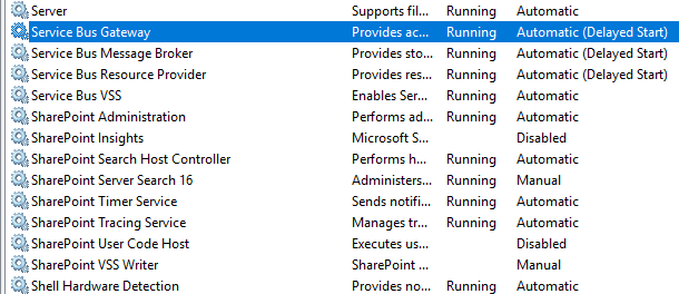

After that noticed the Service Bus Message Broker hanging with "Starting" status. Please advice.
