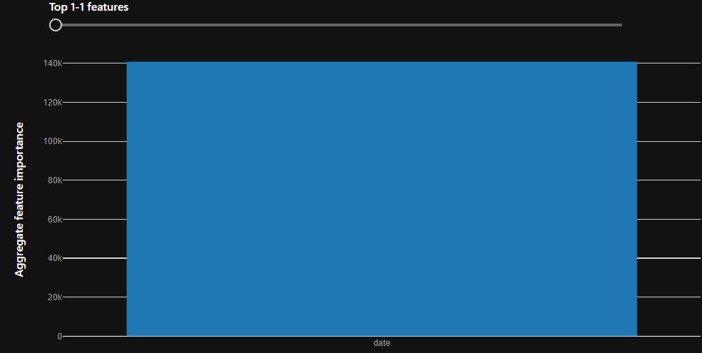

What the problem is
But AutoML does not seem to generate the forecast for target_value based on past values of target_value. It seems to use the date column as the independent variable!
The feature importance chart also shows date as the input feature:
As a side note: running multivariate forecasts works fine.

  1. Ramr-msft 17,836 Reputation points
    2021-04-08T04:12:36.817+00:00
    @Anonymous Thanks, AutoML does use the date column as an independent variable. We engineer several features from it, this is a standard practice for learning seasonal patterns. In the given scenario the date column will be featurized to represent 'day', 'month', 'day of week' etc. This is done to train regression-based model on this data, which will use the generated columns for prediction.
    Please remove the target_lags='auto' to allow selection of Arima. We have to block certain models (e.g. Arima) when the target lags are set. This is a product gap that we're in the process of fixing.
