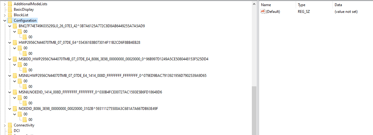

    2019-12-11T20:32:51+00:00
    Problem Solved
    Atwitsend,  thanks you for your assistance.  I cleared all the 6 registry entries and restarted and there was only 1 entry for my BenQ monitor and after a sleep I had the NOEID entry as well.  The resizing and moving problem did not go away yet as we both suspected but I had a pretty clean slate to work from. However before implementing the rest of your corrections I got the thought that perhaps the wy the monitor was communicating with the PC might be an issue even though it should not have been.  So I disconnected the Display Port cable and connected the two with an HDMI cable....and low and behold the problem disappeared. All the windows remained in place and at the proper size with an HDMI connection. The fault may be in Windows 10 or the Monitor  but I will leave that for another pursuit.
    Thanks for your closing comments. I also use the Graphics 630 because I don't do gaming. This PC was designed to do heavy Photoshop and HDR large size image processing. I have been a Photoshopaholic since 1990 and this i9 based processor is the 1st one that I decided not to add a separate graphics card.  I also just migrated to a 27" BenQ monitor developed for photography at a competitive price and it's awesome in performance and color calibration.
    Once again thanks for your assistance.

    2019-12-11T10:42:20+00:00
    Mistermonday,
    Sorry, I'm not sure how to help you. The instructions clearly state to delete entries in the path. You have 6 monitor entries, click on each and press delete. However, your screen shot doesn't show me your even in the right section of the registry (even though you say), and you can really mess up your system.
    I suggest you find someone who knows regedit and can do this for you at your computer, because the following steps are much more difficult than step 2.
    Please don't use regedit if you don't know how.
    Regards,
    @witsend
    PS - Reinstalling windows will not solve this problem at all.

    Hi Atwitsend42,
    I have a brand new PC with a new BenQ monitor (2560 x 1440) and I have the same problem. I have fiddled with the resolution and scaling but I can't get the problem to disappear. As the PC comes out of sleep mode, all of the previously opened windows are smaller in size and are stacked on top of each other at the top left corner of the screen. While I am proficient at h/w and s/w, I have never done a regedit and I am quite ignorant in that regard. However you seem to have discovered a solution and I wonder if you can help walk me through the regedit.
    I went into the path you described in item 1 and took a screen shot. I will attempt to insert the image below.
    I am lost at item 2 of your instructions. Can you please tell me which lines or values to delete and a little more detail on how to proceed from there?
    I put a lot of work into reloading s/w onto this new PC before noticing the resizing and moving anomaly. It would be a huge inconvenience to do a new re-install of Windows 10 because I had to get special permission from a number of s/w suppliers like Adobe to get older apps and licenses reactivated.
    Any assistance you could provide will be greatly appreciated.
