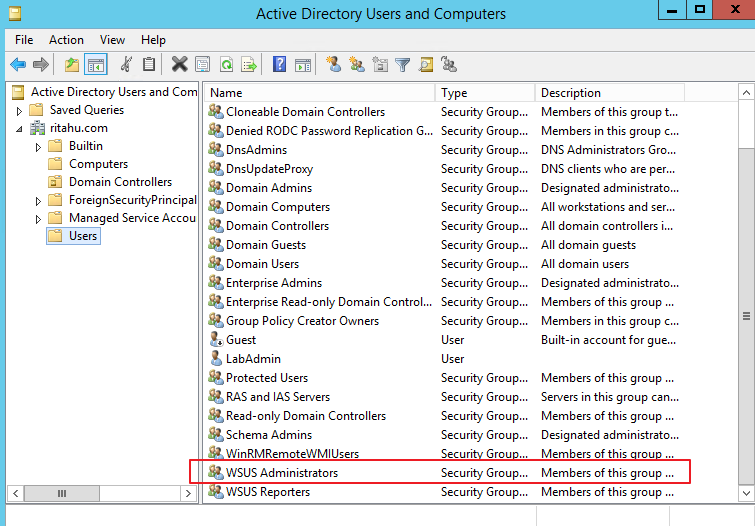

    Reference picture in my environment:
    So users who logged in the windows 10 computer must be the number of the group named WSUS Administrators to manage the WSUS role.
