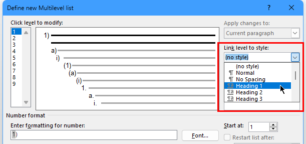

    You have to set this up in the Define New Multilevel List... dialog - click Multilevel List on the Home tab of the ribbon,
    In the dialog, click More >> to display the extra options.
    You can link each level of your multilevel list to a style.

    You use that to create and name a list style, within that dialog, when you format numbering you go to the Define New MultiLevel List Dialog. The key is to assign a separate existing paragraph style to each level of numbering. The styles can be built-in styles- or custom styles.

    For styles attached this way, you also control the left indents through the Define New MultiLevel List dialog not the Ruler or the Modify Style dialog.

    The basic idea is that the numbering is set using the Define MultiLevel List dialog with each numbering level being attached to an existing paragraph style. Once you have this set up, you should not use the buttons for numbering in the Ribbon but rather apply the appropriate style for that level.
