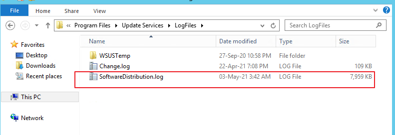

Here is a update of the case. I review the information you provided above. It seems that the metadata have been corrupted. I found that the downloaded updates are all .exe files in the software distribution log in your environment:
However, the updates files are all .cab in my environment:
The .cab files are Binary update files which are used to be installed on the clients.

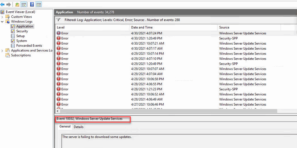

    No proxy in our environment. I already connected to the URL and it downloads some files. I have tried installing it two times but no clue!! No KB number is getting downloaded for some of them it shows 100% or 75% or 25% but in the folder it does not show any content(shows zero mb). Also now it shows error 10032 event code.

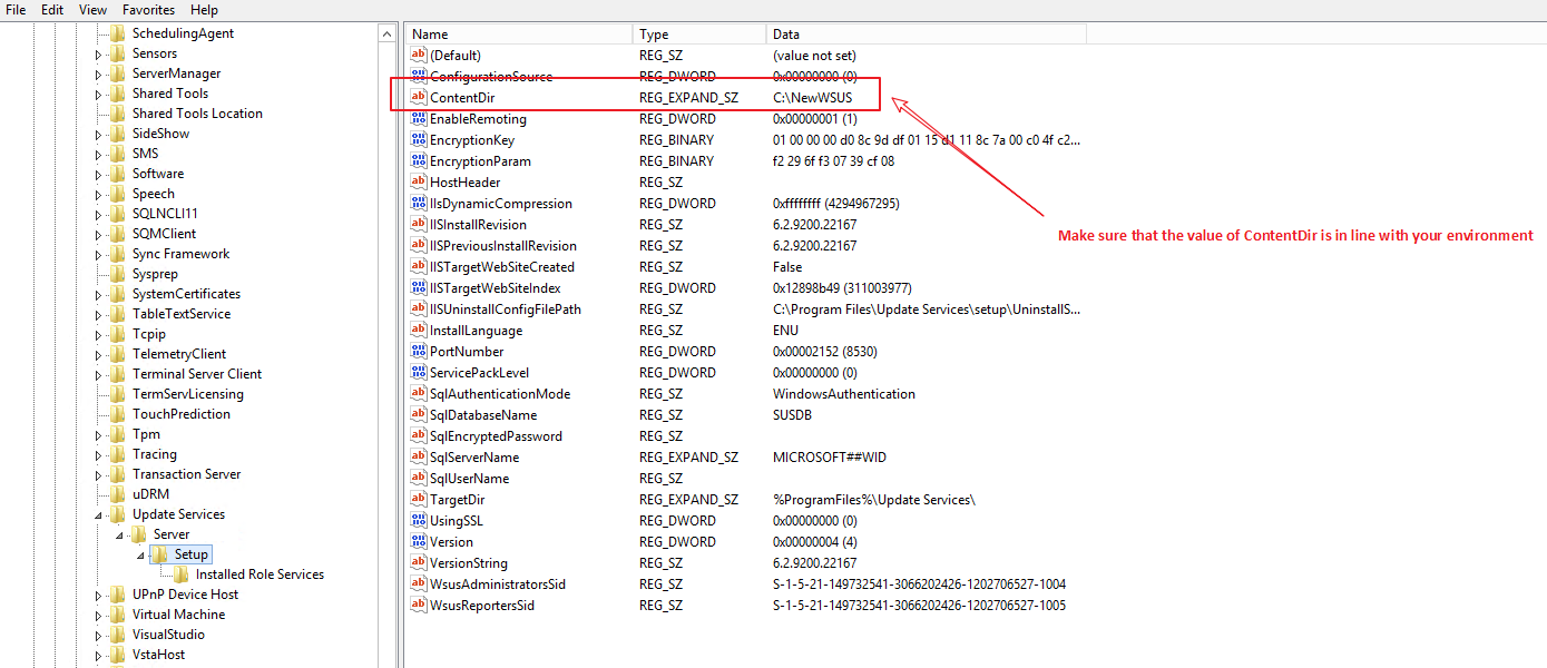

    I have checked these values and they are correct:92711-wsus-values.gif
    Any clue!!

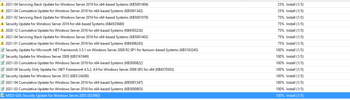

    config wizard did not resolve it. Approving the updates on downstream server did not resolved it and approving other updates also did not resolved it. Actually it shows that some updates are downloaded 100% abd some are 65% and 25% but if you ho to downloaded location it shows zero bytes means nothing is downloaded.
