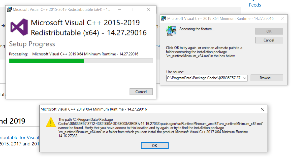

When I try to install Microsoft Visual C++ 2015-2019 Redistributable (x64) - 14.27.29016 I get an error popup that says the following
and if I try to hit "OK" this pops up

    This is how I fixed my issue - Very quickly!
    I was trying to install C++ 2019 v14.26xx and getting the .msi error. So going backwards I went to Add/Remove programs and looked for the last version of C++ installed which was C++ 2017 V11.xx (x86 & x64). I removed both which gave the error that they were already uninstalled and asked to remove them from the list. Which I did.
    Then went to \HKEY_LOCAL_MACHINE\SOFTWARE\Classes\Installer\Products and found the keys for C++ 2017 I just removed. (there were 4 total 2 x86 & 2 x64). I deleted all 4 keys then ran the C++ 2019 package I originally had the issue with. It installed with no issues.

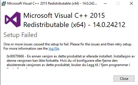

    now i just get this message that says that another version of this product is already installed
    13 people found this answer helpful.
    2020-08-07T11:41:23+00:00
    then go to control panel/ program and features, search for the 2015 and try to repair the installation or uninstall it and install it again.

    I just tried your solution proposed by this thread, and it didn't work. I got stuck in a constant loop this other guy got stuck in, with the pop ups, and was wondering if you could contact me directly at my email @******@gmail.com , as you are clearly more experienced and would love if you could make some time to help me out. If you need any information about the problem im getting, It started 9/2/20 roughly 9:00 PM EST, where i logged onto a game, "Valorant", and an update hit me with the popups seen below. The error in the top left corner of the picture is what i saw first, but then i tried to download/redownload the program, and i saw top left, then top right, then bottom, while trying to download. I have all previous Visual C++ installed, (2008-2013), but whenever trying to install the 2015-2019 this would hit me. If you can get back to me Id appreciate it.
