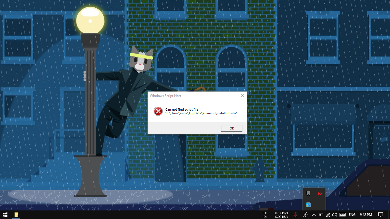

After resetting the windows 10 when I start the PC, this error pop up in start-up. This shows that it can not find script file 'C:\Users\aviba\AppData\Roaming\install.db.vbs'. How to solve this error?

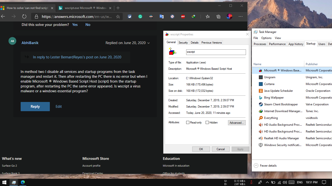

    2020-06-20T17:20:35+00:00
    In method two I disable all services and startup programs from the task manager and restart it. Then after restarting the PC there is no error but when I enable Microsoft ® Windows Based Script Host (script) from the startup program, after restarting the PC the same error appeared. Is wscript a virus malware or a windows essential program?   ![](https://learn-attachment.microsoft.com/api/attachments/06b80ef7-f467-468f-9f92-7acd649b7e2d?platform=QnA
