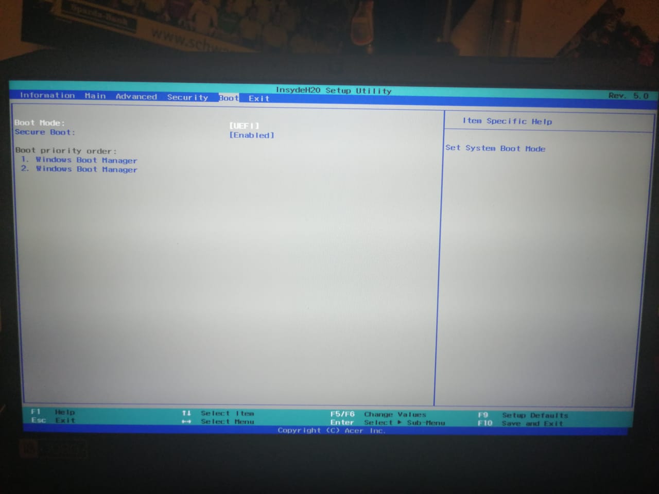

So I shut down the computer, got into the UEFI menu in order to try change the boot order, but the thing is whenever I go to the "Boot" tab, Windows Boot Manager is listed Twice, and the only item listed under "Boot Mode" is UEFI, cant even change it to Legacy, I even tried setting up a UEFI password, but still no luck.

    Both the SSD and HDD are conected (inside the laptop), but I disabled the HDD port in the UEFI settings. If I enable that port the computer will automatically choose the HDD drive as the primary drive and the SSD will be set as a storage drive, I cant change this in the "Boot" tab as the only options it gives me are two instances of "Windows boot manager"

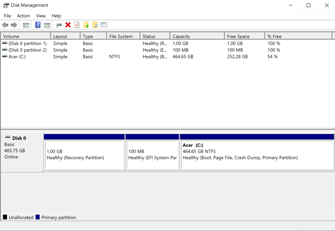

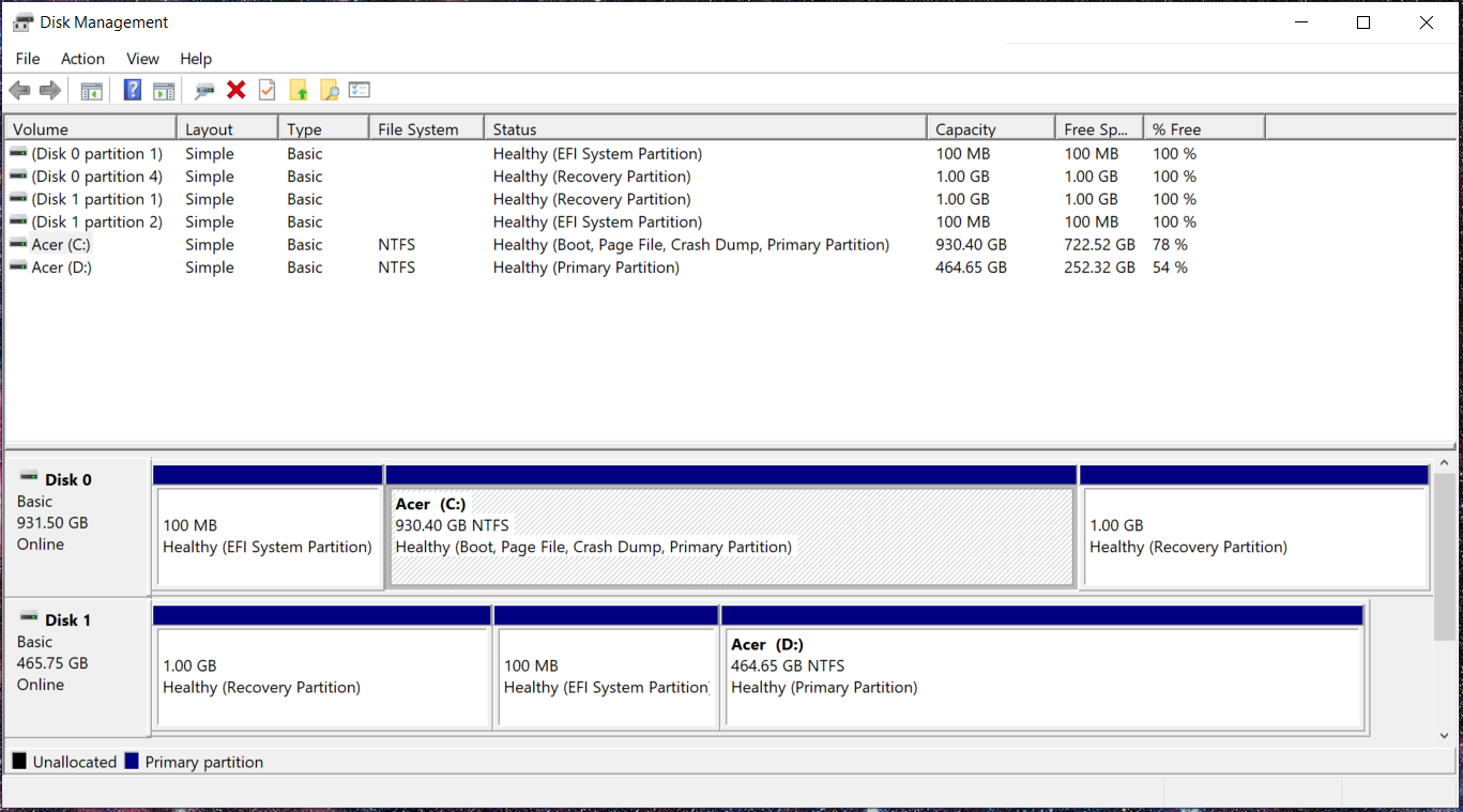

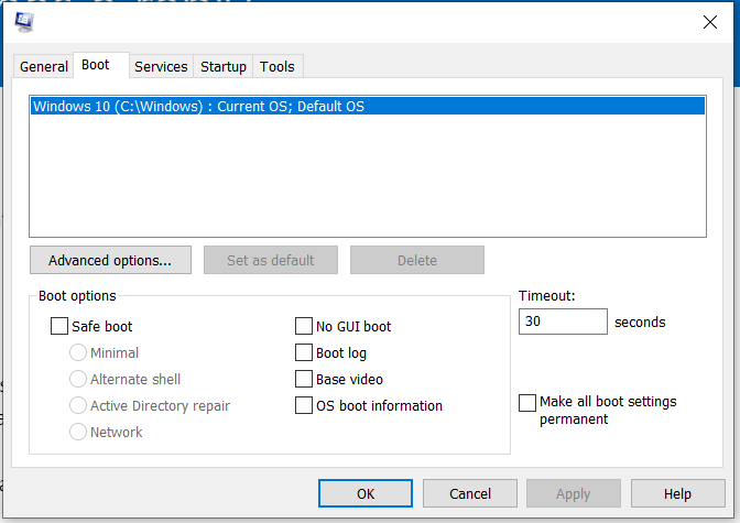

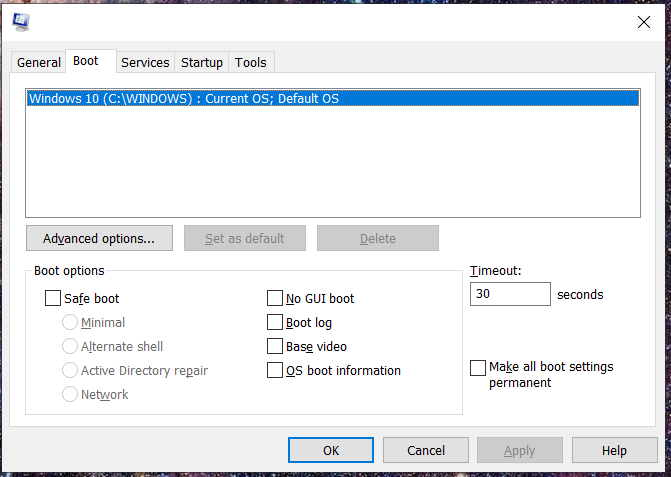

    2020-07-03T14:06:16+00:00
    Hello Antonio, Thank you for your response.
    This is what I get when I get into the Boot tab on msconfig using both drives.
    For comparison, this is what I get with only the SSD connected to the motherboard.
    In case this helps you, this is what I get under Disk management with both drives connected (the 1TB is the HDD, and the 500GB is the SSD)
    And this is what I get when I disconnect the HDD from the motherboard.
