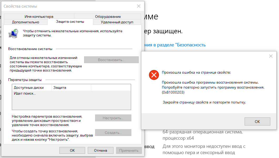

Windows version is Windows 10 Professional 21H1 build 19043.1165 with latest updates. The volume is BitLocker encrypted.
Yesterday just navigating through tabs on System Properties dialog, I occasionally found that System Restore fails to launch with error 0x81000203:
Open tab in English probably is "System protection".
I tried to boot in safe mode (booted OK), and launch System Restore but it also don't works.

    I have resolved the problem.
    Solutions found:
    This was a problem caused by the installer of AOMEI Backupper in one of it's versions and future installers were not fixing it.
    There was no value 'volsnap' in the UpperFilters param of Компьютер\HKEY_LOCAL_MACHINE\SYSTEM\CurrentControlSet\Control\Class{71a27cdd-812a-11d0-bec7-08002be2092f} registry key. Added volsnap there manually, rebooted and problem is now resolved.
    Thanks.
