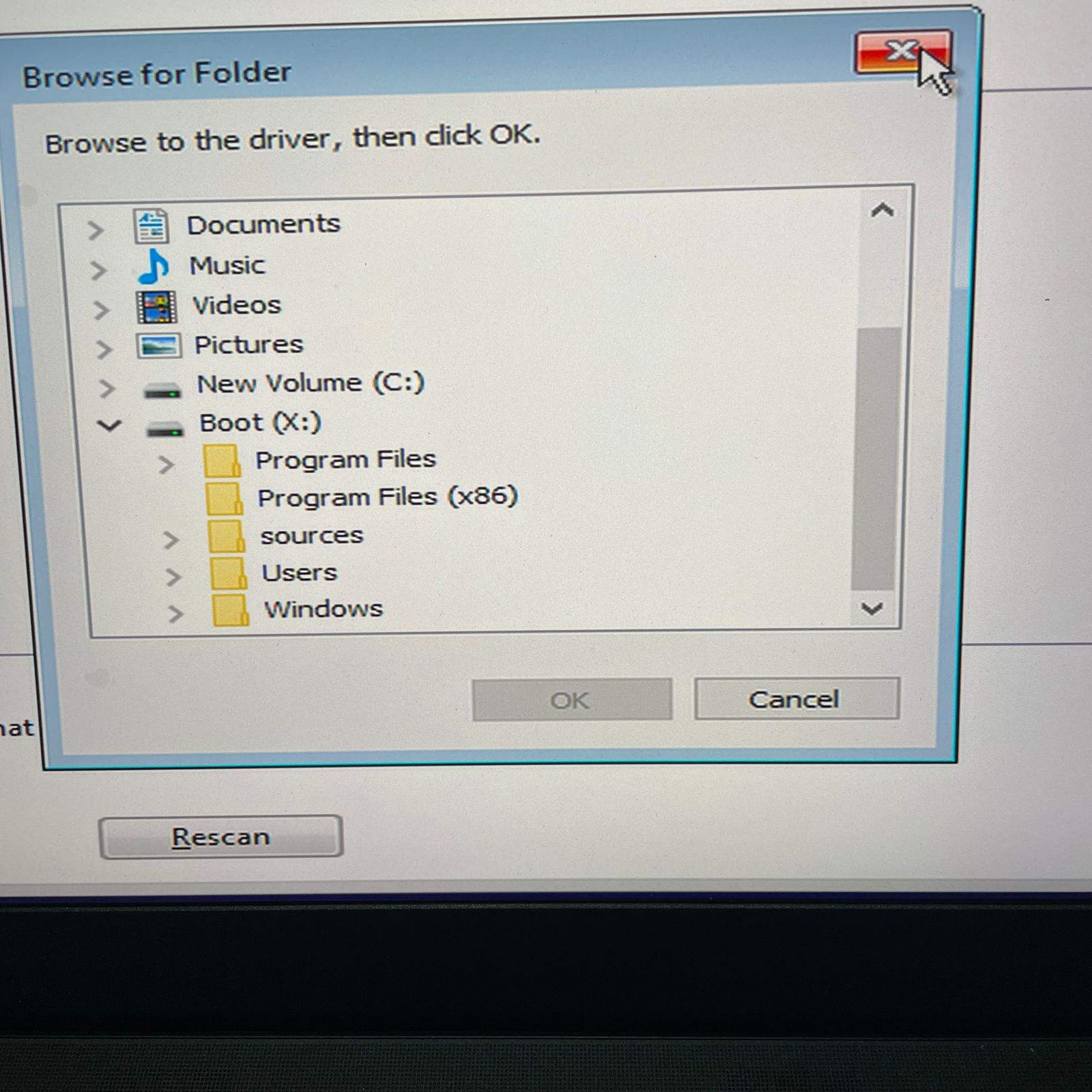

    Hello, regarding the 1st part, I pasted them on the USB memory as instructed, but when I the PC loaded the installation asked again for the drivers, then I wanted to search for the folder with the drivers but I couldn't find it, it shows 2 disks: the C is the new SSD and the "Boot (X:)" I couldn't confirm which disk is that, since also I created a folder with drivers on the SSD I want to install Windows, but (as the picture shows) there isn't shown, also I don't recognize those folders from the USB memory with the Windows installation.
    Regarding the 2nd part, I've used it previously with any success.

  3. Ramesh Srinivasan 80,640 Reputation points Independent Advisor
    2025-03-03T03:52:24+00:00
    Hi Brayan,
    1. Have you used the Windows 10 setup disk and extracted the IRST drivers to the setup disk? You still need to load the drivers when booting from the Windows 10 setup disk.
    2. If the load driver option (when booted from the Windows 10 setup disk) didn't help, please try the following drivers.
