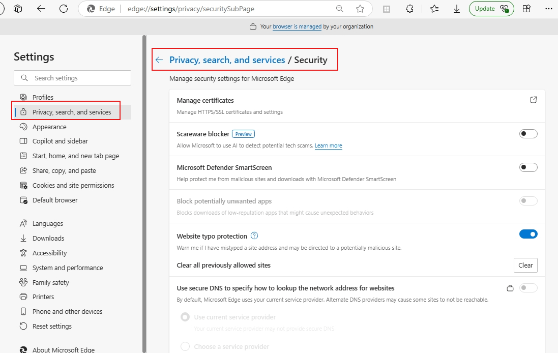

    For the Internet Options associated with TLS/SSL you mentioned, in addition to the parameters under the "Advanced" tab, you can also check the contents under the "Security" tab and consider whether you need to restore the security settings to the default values ​​based on your needs. For the Content tab, you can also perform a similar check or Reset/Clear operation. For example, "Clear SSL state".

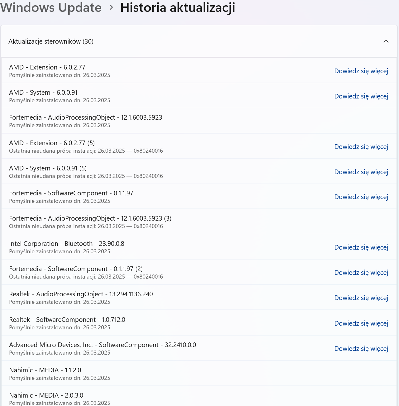

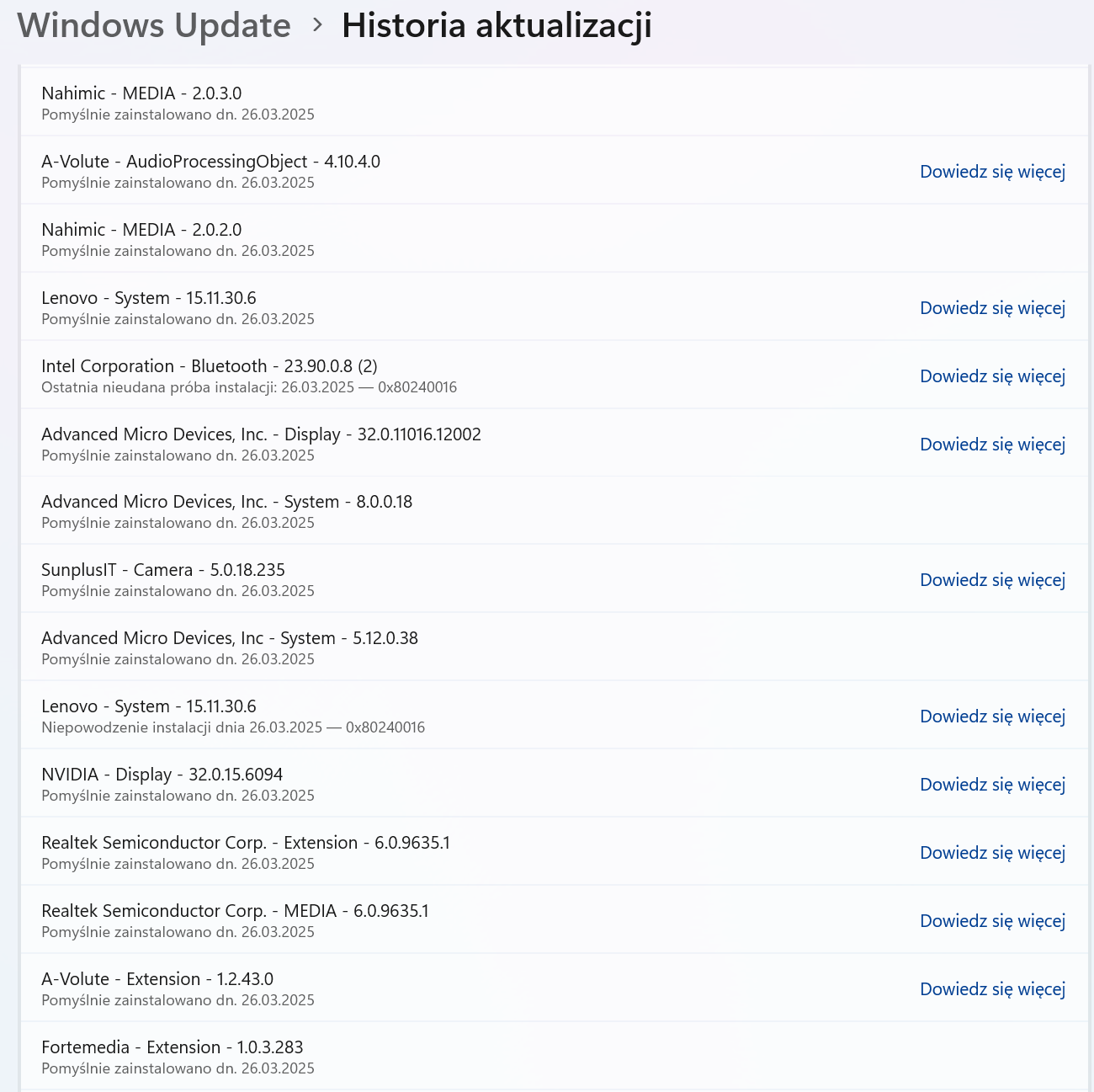

    On some devices, the system may provide an option called "Fix problems using Windows Update", which is a process similar to "In-place Upgrade" and theoretically does not directly affect the data in the device.

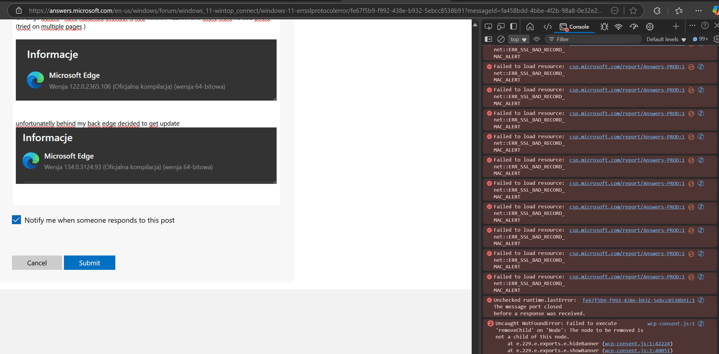

    2025-03-26T23:32:32+00:00
    Thanks for fast reply
    i have tried what you have described and still no luck
    but to narrow where issue could be i have just run a fresh installation on Windows 11 pro with bypassnro to avoid any additional update installation
    currently im running
    Version Windows 11 Pro 24H2
    Compilation 26100.2033
    Windows Feature Experience Pack 1000.26100.23.0
    Windows update was not run yet as i have assumed its one of updates there but as i can see system has done auto update of lots of drivers.
    Did not restart system yes so some of them may not be applied yet

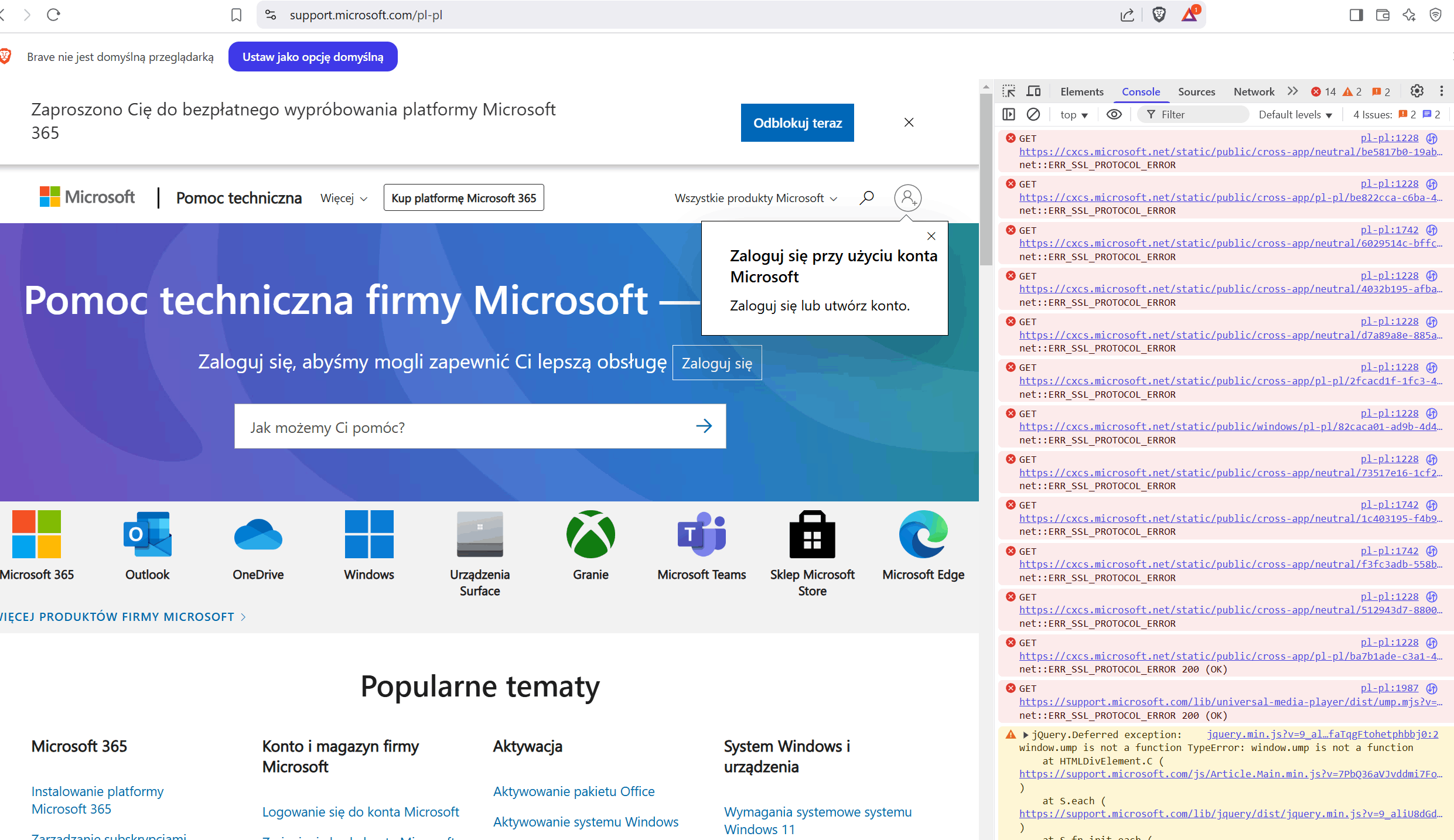

    BUT in the meantime i have installed Brave Browser which has newest chromium engine and SSL error was there already
    Version 1.76.82 Chromium: 134.0.6998.178 (Official version) (64-bit)

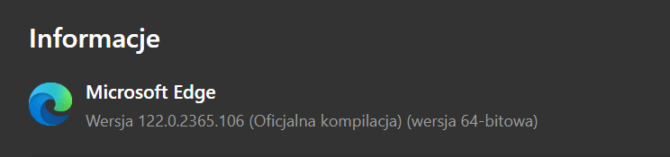

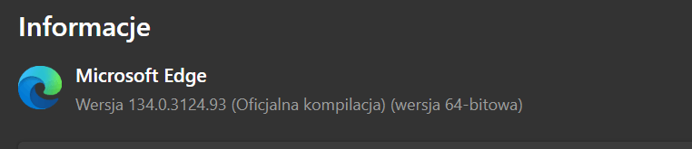

    On Edge before i have restarted browser it had version 122.xxx and there were no SSL errors (tried on multiple pages )
    unfortunatelly behind my back edge decided to get update
    and here we go again
    Im open to Suggestions, we can start again from basics to check what is going on here, i cannot work on that system any more

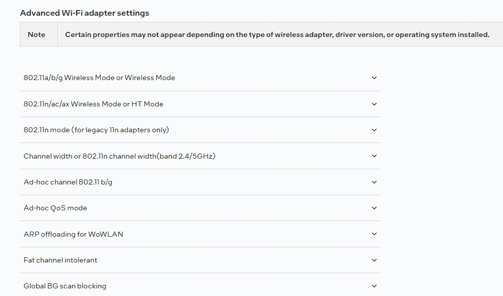

    If the "Wi-Fi" you mentioned does not include hotspot networks shared by mobile devices, you can try to check any advanced security features of the router itself, such as "HTTPS Inspection" or "SSL/TLS Filtering" (if enabled).
    For the network adapter itself, you can try to check and test different parameters of the "Advanced" tab.
    • Right-click Start in the bottom left corner**.**
    • Click Device Manager.
    • Click the > sign to expand the Network adapters entry.
    • Right-click the wireless adapter and click Properties.
    • Click the Advanced tab to configure the advanced settings.
    • Advanced Intel® Wireless Adapter Settings

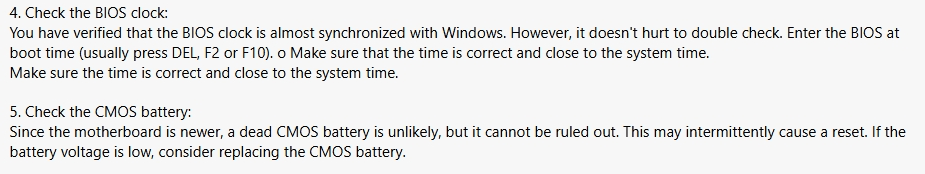

    Although in our experience so far BIOS/UEFI options usually do not directly affect network behavior, given that the problem seems to manifest itself at the system-wide level, if you wish, you can try checking some BIOS/UEFI options related to security checks/power policies/power states, such as but not limited to Secure Boot, ERP, C-State, E-Core.

    will try to flash bios with lates version tho and reset to defaut after that, clock in BIOS is same as in windows and windows has auto time
