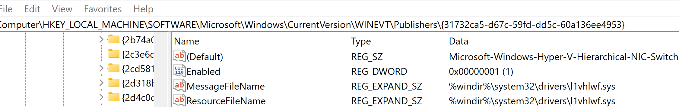

    I had this same problem and found the answer. I was running a Win11 in Hyper-V.
    The registry editor search revealed what "l1vhlwf" service actually is:
    "l1vhlwf" is Microsoft-Windows-Hyper-V-Hierarchical-NIC-Switch
    Solution for me was to delete the switch from Hyper-V Manager's Virtual Switch Manager and (after reboot of Host) I was able to get back in to Guest.
    The whole thing started when I was very eager to restart VM and constantly tapped enter at that point as stress test. There is a bug(s?) in current restart procedure as it stalls twice during restart demanding user input.
    Then removing the the whole adapter from Hyper-V Manager's Virtual Machine's Settings Hardware/Network Adapter and adding it back with same Hardware/Add Hardware and rebooting Host allowed me to get internet back on for Guest.
    It seems generally any remove of any virtual machine's network adapter demands rebooting of Host. I spent several hours before I got that hammered in so I hope you don't need to.
