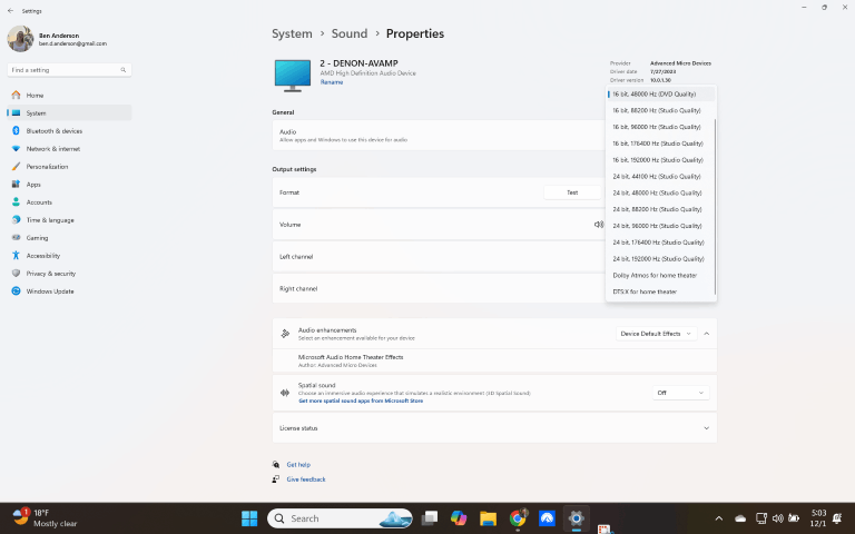

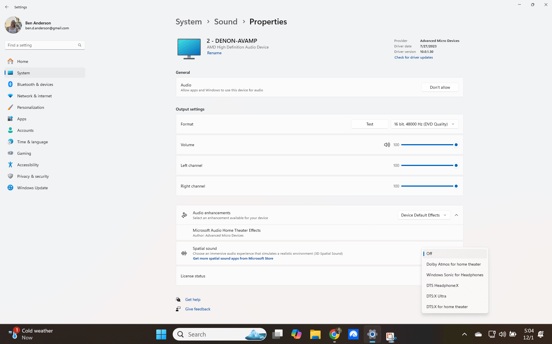

    2024-12-03T18:21:02+00:00
    I have the same problem. I have my computer connected via HMDI to my reciever and want to play games on 5.1. My reciever doesn't support Atmos or DTSX.
    I can't get windows 11 to send a 5.1 signal. The option existed on Windows 10 and is just gone on Windows 11. Microsoft help ppl just send me in circles around pointing the problem at somewhere else. Windows 11 doesn't have the option and needs to add it back. See my screenshot.
    10+ people found this answer helpful.
