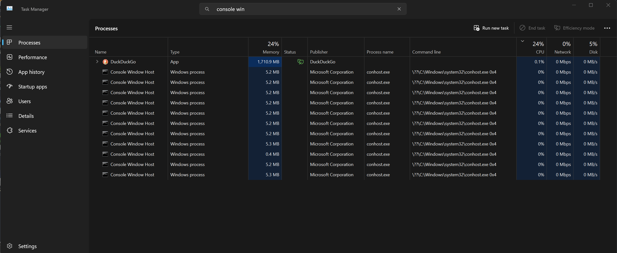

I hope you can help me with an issue I’m experiencing on my Windows computer. I’ve noticed that there are over 11 instances of Console Window Host (conhost.exe) running in Task Manager, and it’s raising some red flags for me.
I have a reasonable suspicion that my system might be compromised, possibly with a cryptocurrency miner (like Bitcoin or XMR). I’m particularly concerned because I see multiple tasks running under NT AUTHORITY\SYSTEM privileges and they appear to be linked to my user account (User/Alex).
Here’s the backstory: recently, while using a public library computer, I stepped away for just a moment. When I returned, my computer was at the BIOS screen, which seemed very unusual. This has led me to believe that someone might have accessed my machine and installed something malicious.
I’ve done quite a bit of searching online and the results point towards possible malware or a trojan, but I’m not sure how to proceed with diagnosing or removing any potential threats.
If anyone has advice or suggestions on how to handle this situation, I would greatly appreciate it. I can provide screenshots for reference as well.
I have ran Rkill, Eset(which never ended up scanning or updating), Process Killer, Malwarebytes, Norton Security, god im running out of options, But I seriously need help..

I'll check in tomorrow morning and see what's going on as far as updates. I cant seem to figure out what is running the background executables and I seriously need help

    Windows PowerShell Copyright (C) Microsoft Corporation. All rights reserved. Install the latest PowerShell for new features and improvements! https://aka.ms/PSWindows PS C:\Users\Alex> Get-Process conhost | Select Id, @{l='Parent';e={$_.Parent.Path}}
    Id Parent -- ------
    8516
    8556
    8688
    8880
    9124
    9360
    9504
    9612
    10300
    21052
    24992
    31124
    32880
    PS C:\Users\Alex>
    give me a moment to look and find out
    I took the time to prt scrn the parent id's 1 by 1 and we'll go through them one by one:
    wlan.exe (must be the vpn wlan I have configured through DDG browser vpn) wlanext.exe Windows Wireless LAN KEWL BEANS
    NVidia (Good)Image
    Gotta be the Razer Basilik Mouse Device I have
    Razer App Manager (looking gewd)
    Razer Diagnostics (supra ultra gewd)
    Razer Synapse (totally gewd)
    Razer Device manager (looks gewd)
    Razer Smart Light (looking gewwd)
    KAPSService.exe (Looking into this one) killer analytics serviceImage
    Msi bloatware (Looks Good)
    SteelSeriesSonar(Good)Image
    So as I see it's just mostly Razer Bloatware and some other functions. How were you able to tell and come to the conclusion from looking at the
    First + Additon logs files to determine if there were any Malware or if there's any trojans? Also I'm curious to know because im learning and getting more into OS and other functionalities as far as computers, does a computer usually need and require so much RAM even at IDLE? I'm trying to see and figure out why maybe a article or if you can point me into a direction that can initially explain for the High RAM usage as far as the computer being at idle.

    That's Powershell 5 output. To get the parent in Powershell 5, run:
    $obj = Get-Process conhost | % {
        $ppid = (Get-CimInstance CIM_Process | ? ProcessId -eq $_.id).ParentProcessId
        [PSCustomObject]@{
            Id = $_.Id
            ParentId = $ppid
            ParentPath = ((Get-Process | ? Id -eq $ppid).Path)
    $obj | ft -auto

    Hi Alexander, This is Ramesh.
    The system might be infected by miners. To verify that, please run the Farbar Scanner and share your logs on OneDrive.

    Do you know what steelseriessonar.exe is?
    To thoroughly check for malware, please run a scan with Farbar Recovery Scan Tool (FRST) and share your logs.
    https://www.bleepingcomputer.com/download/farbar-recovery-scan-tool/
