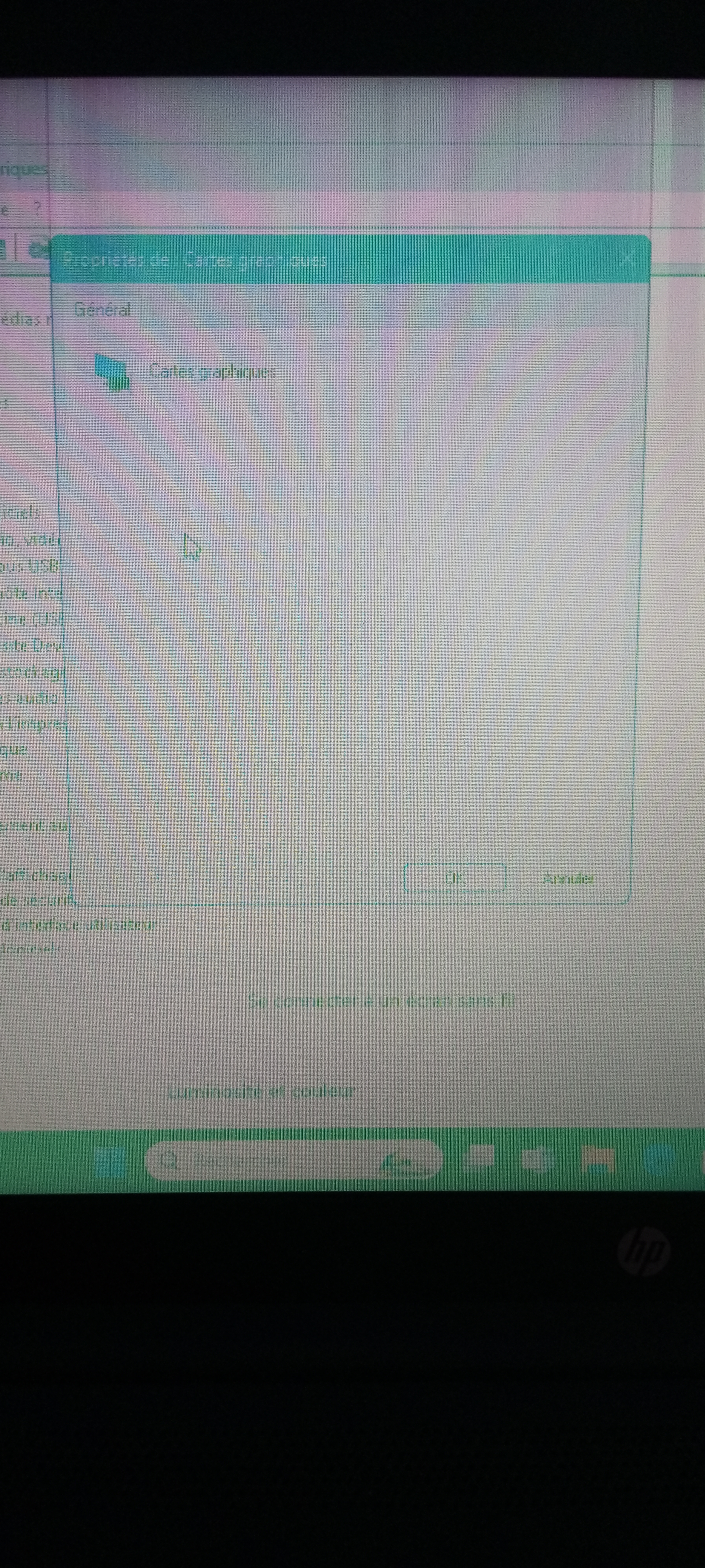

    ImageHello,
    I'm really so thankful that I got a response, as you said I tried connecting my laptop with another device, and it seems like the problem is from the screen because once I connected my laptop with my tv, the screen looked normal on the tv (has so green tint), and I followed your steps for updating graphic drivers but as you can see when I click on properties, it don't show any other options, now I'm restarting the laptop and I'll try again.

    Greetings! My name is Arif, and I will assist you today.
    I am sorry to hear that you are facing this issue. Have you tried connecting an external monitor to see if the same display problem appears on the external monitor? Based on the screenshot you shared, it seems more likely to be a hardware issue rather than a software issue. It’s better to check with the external monitor first to see if you are facing the same problem.
    Additionally, have you tried updating or reinstalling the graphics drivers and then restarting your PC?
