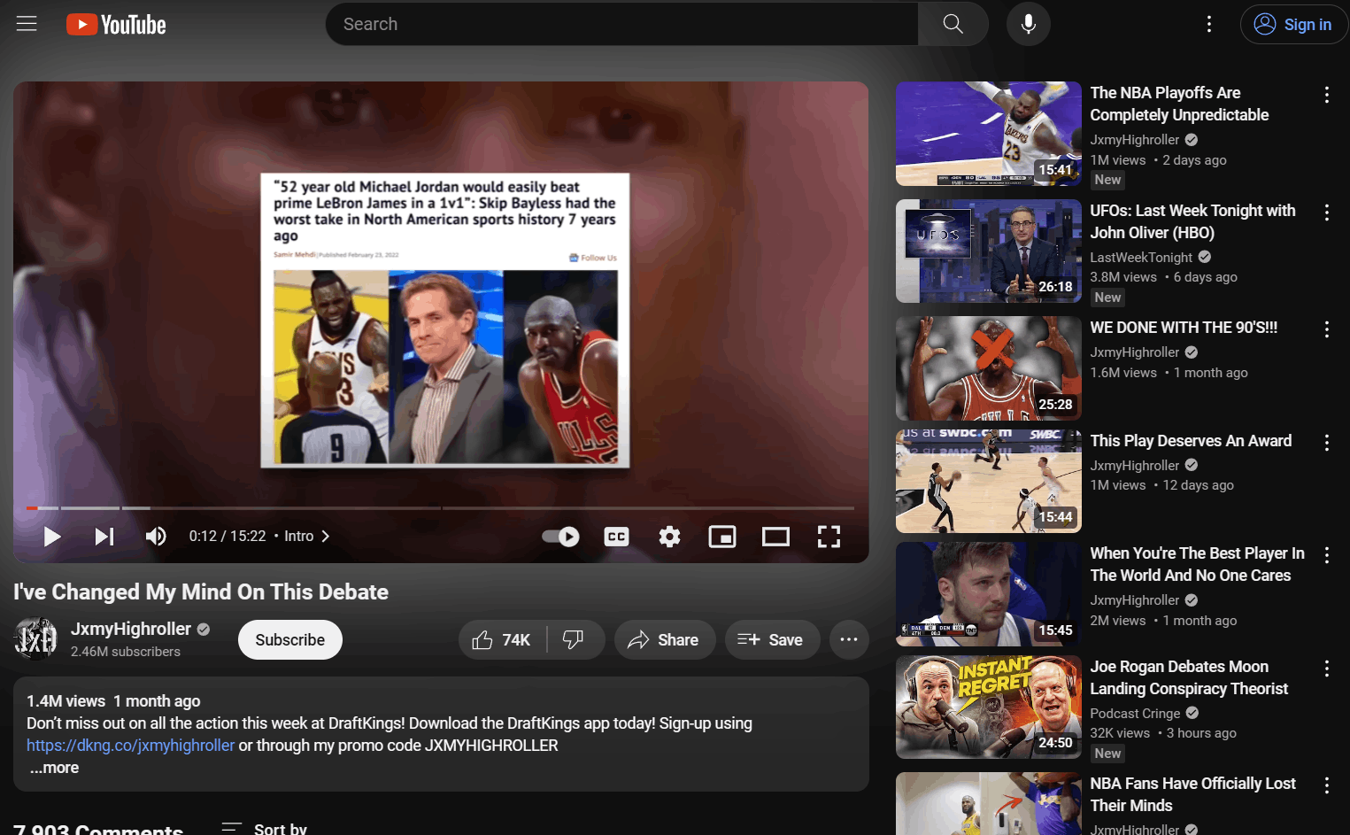

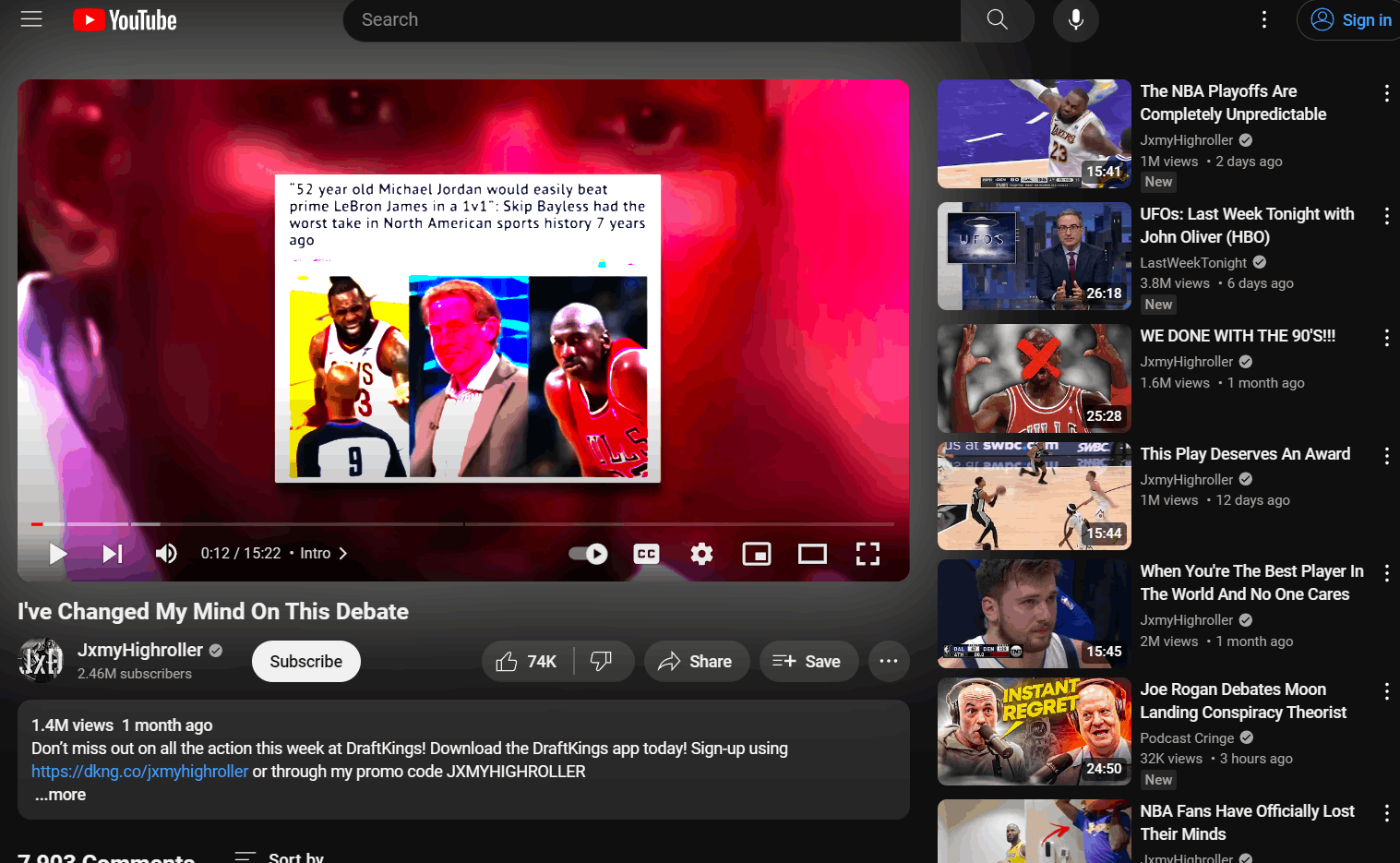

While you won't be able to see the HDR extreme brightness (it's lost by the copying and pasting and you need an HDR display to achieve those high brightness levels), you can see how the colors are distorted and washed out. Here it is on the HDR monitor:
Here's the same window simply dragged over to a non-HDR monitor, where it looks correct, note that ONLY THE VIDEO image has changed, the rest of the window is identical:

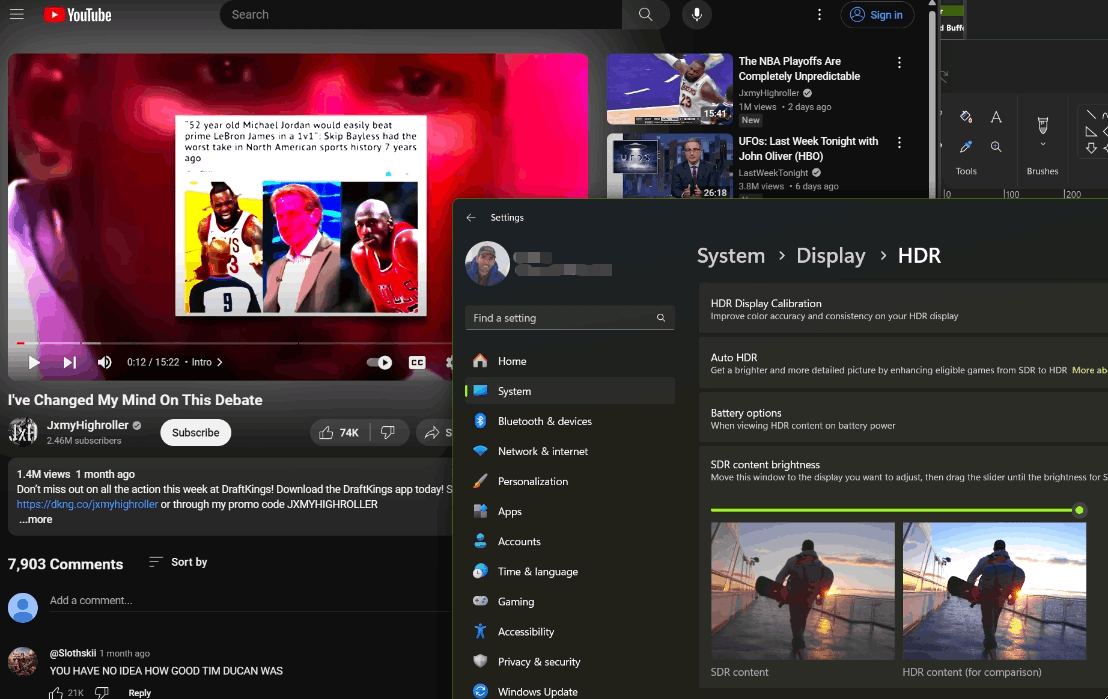

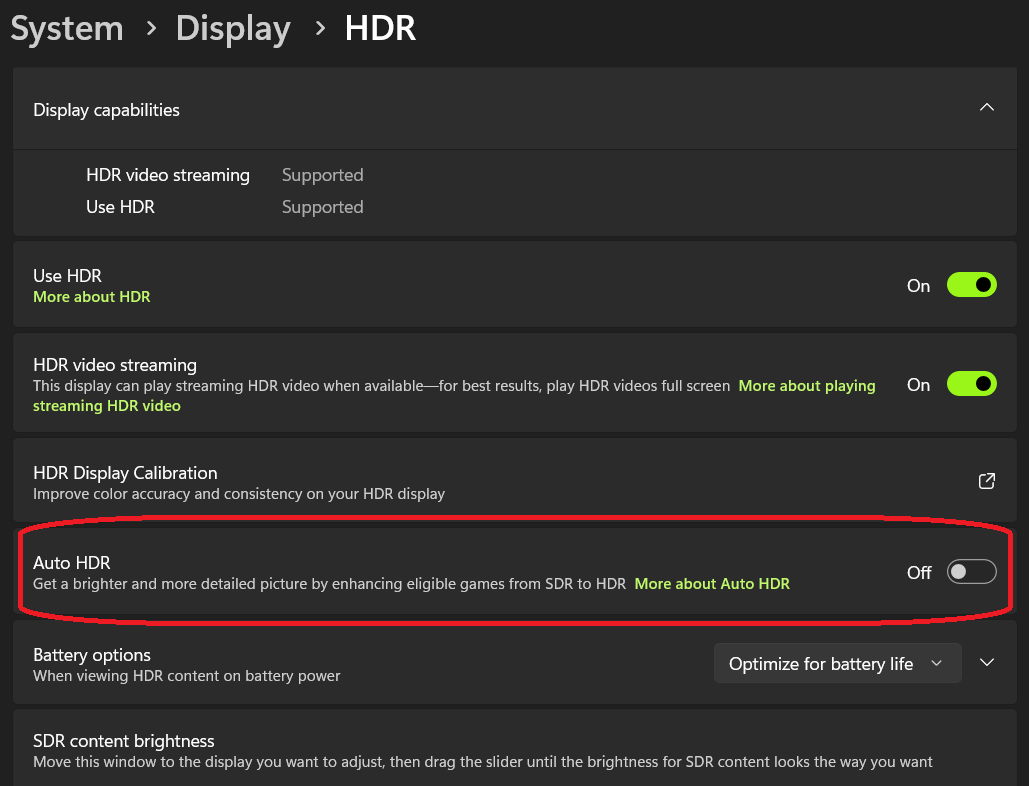

Windows Settings includes "Auto HDR" for enhancing SDR videos. That sounded like the culprit, but turning it off it had no effect:
Windows also includes a slider for "SDR content brightness," (see bottom of screenshot above and bottom right of screenshots below), but ironically, dragging that slider adjusts everything -- all SDR windows, desktop color background, etc., -- EXCEPT THE PROBLEM VIDEOS. Those seem to get their palette from something else and don't change with adjustments to the SDR content brightness slider. The one thing I want that slider to change is the one thing that remains unaffected. Oh what a twist.

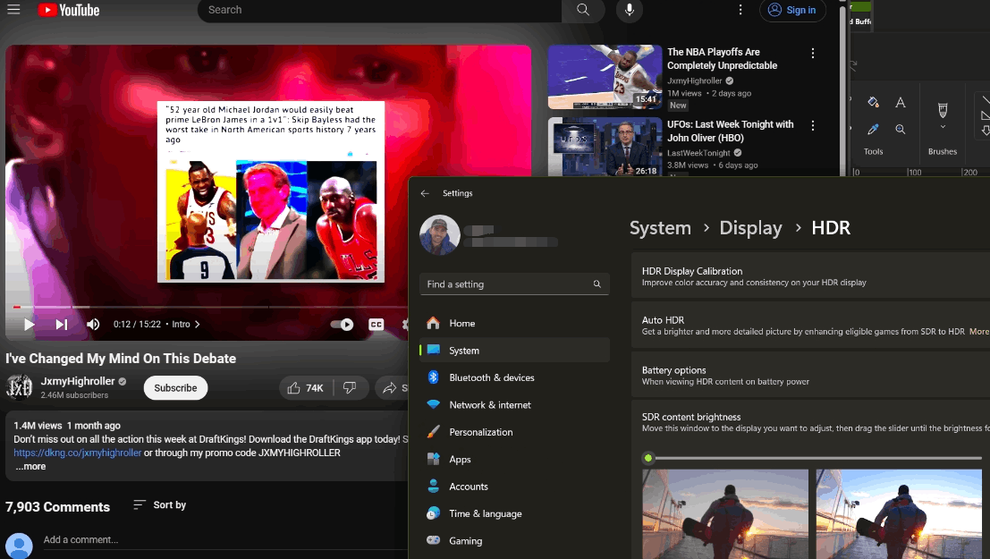

Note here with the SDR content brightness slider at minimum (see slider to the lower right), the video is the same as above, washed out:
Here's the same scene with the slider turned all the way up. I'm not sure there the posts here show any difference that you can see (looks like the pasted images are the same), but I can tell you that for me while I was making the change, everything else got much brighter, but the video picture did not change as I moved the slider:

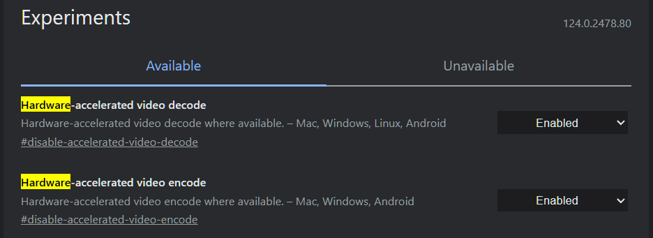

    You mentioned that YouTube videos are oversaturated with Windows in HDR mode. I would suggest that you could first try enabling hardware decoding in Edge as detailed below.
    1. Type edge://flags/ in the search bar at the top of Edge.
    2. In the interface that opens, type Hardware-accelerated video decode in the search field, and then set this feature to enabled.
    3. Test if your problem will just show up
    If, you have tried the above and the problem still persists, then the problem is most likely related to your NVIDIA graphics card and I would suggest that you can get in touch with NVIDIA's technical support staff, which will help you to get more information. You can click on the link below to submit your question.
    https://www.nvidia.com/en-us/support/
    We hope that your problem can be solved properly, thank you for your understanding.
    Best regards
    Brian - Microsoft Community Support Specialist
    Brian, that flag is enabled by default (see screenshots below, where those are original values, not ones I've manually changed). See other note in this thread from Pet0rUK that this was a reported bug, fixed in Chrome, but that MS has apparently not incorporated this update for some reason.

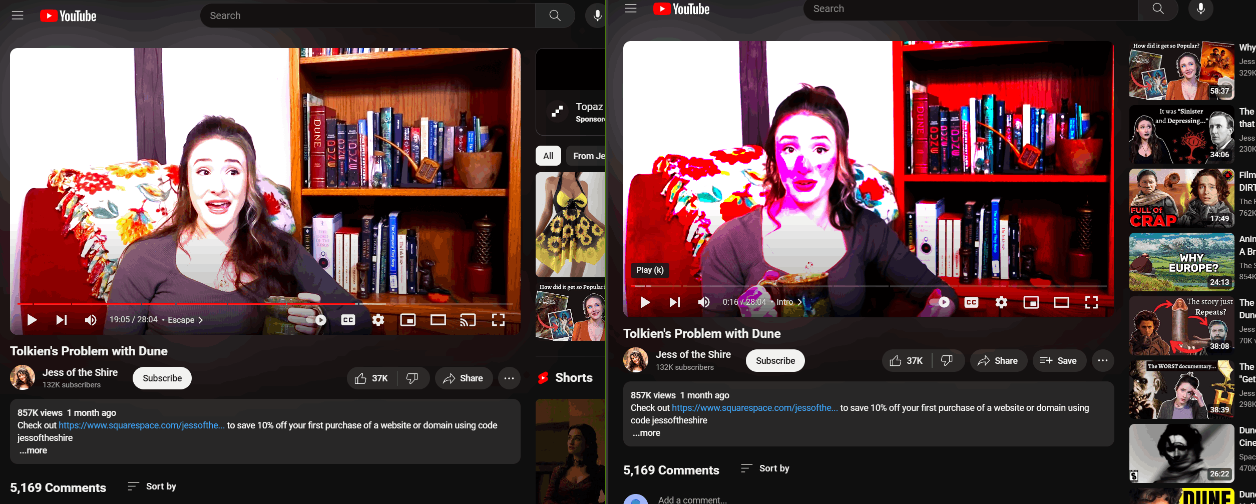

    And to be clear, here's the same URL in Chrome (on the left) and Edge (on the right). Clearly, Edge has some defect that is not in Chrome. Note that the pasted image is not identical to how these appear to me, but you can still there is a strong difference between the two browsers, even though they are supposedly running the same code (could this even by an intentional act by Google to ensure YouTube doesn't look right on Edge, at least not for anyone with HDR monitors?):
