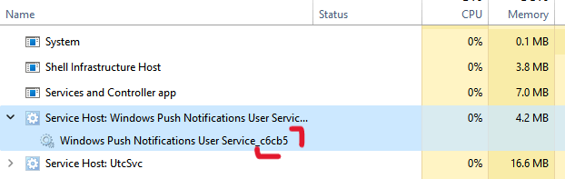

A process by the name of svchost.exe 'Service Host: Windows Push Notifications User Service_[INSERT_NUMBERS_HERE]' is using up all my memory. Typically using at most 23% of my CPU.
I need to force end task on Task Manager every time and it seems to appear randomly. Is this a virus or just a bug? What do I do to fix this?

    The presence of "Service Host: Windows Push Notifications" is normal and the system may depend on this service to push some messages.
    In your case, however, the process does not have a service number, it does not seem to be a standard push notification process.
    It appears that the process is not properly initialized to be associated with some specific application.

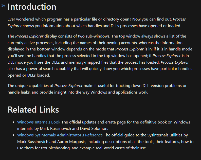

    • If you use an advanced tool to track the process, will you get more information from that tool? Process Explorer - Sysinternals | Microsoft Learn
    For detailed tips on using Process Explorer, you may want to consult a more experienced community.
