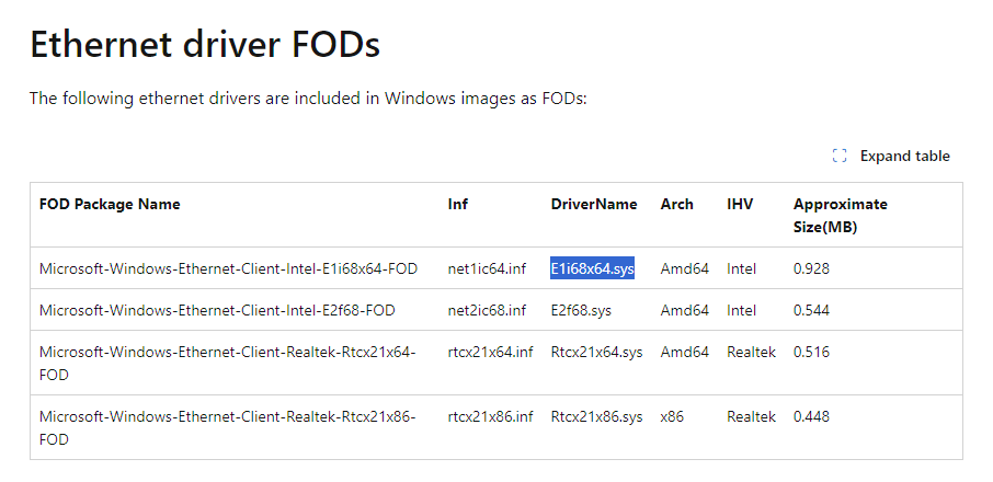

    2024-02-16T03:48:16+00:00
    Hi
    Thanks for your reply.
    The latest log error indicates that there is a conflict between your NVIDIA driver and the Intel Ethernet driver. The specific file involved is e1i68x64.sys. You can check for the relevant drivers and try uninstalling and reinstalling them.
    Here is the related article.
