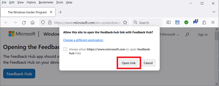

    When I browse to Don T's bug report at https://aka.ms/AAo1su9 in my default Firefox browser I see a pop-up asking me to click Open Link to launch my Feedback Hub app and automatically open the correct bug report. I don't know if it's relevant but when I boot up my computer I normally log in with a Microsoft account.

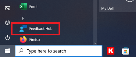

    Instead of using my browser I can also launch the Feedback Hub app directly from the Start button on my task bar ...

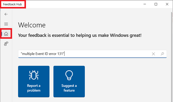

    ... and if I search for "multiple Event ID error 131" on the Home tab of the Feedback Hub then Don T's bug report titled "Getting multiple Event ID error 131 Device Set-up Manager" (currently with 49 upvotes) is the first bug report listed in the search results. If you simply search for "Event ID 131" you'll find that multiple users have created bug reports for this same Event ID 131 error so an upvote for any of those bug reports should help to get Microsoft's attention.
