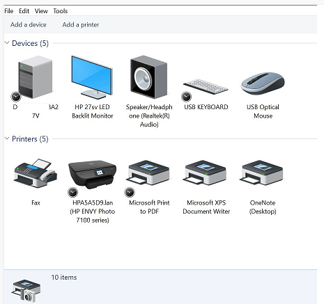

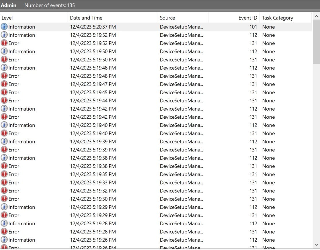

Hello all. I have an HP Omen desktop with Win10 Home 22H2 Build 19045.3693 and my wife has an HP Envy Laptop with Win10 Home 22H2 Build 19045.3693. I was wondering if users were getting multiple Event ID error 131 Device Set-up Manager and getting the little clocks beside my installed devices in Control Panels Devices and Printers that come and go. I have done everything from running SFC, DISM, Virus Scans you name it to try and solve this problem but nothing. According to one of the Independent Advisors here in the Forum it was being caused by Update KB5032278 and to uninstall it which I did and still no change. I do not know what is going on and what Microsoft has done but this is clearly a Microsoft problem and Microsoft needs to fix it. This will be the last Optional Update that will be installed on our computers unless it is a driver update. This does not seem to cause any computer problems but what problems will this cause later on if it is not fixed. This is totally ridiculous.
Don
UPDATE: The only way I have found to stop these error 131 and clear the timer clocks from my devices is to go into System Properties then Hardware and turn off Device Installation Settings and also cleared the Device Setup Manager in Events Log and disabled the log until MS gets this fixed.

    The problem you describe may be caused by a device enumeration problem with the Windows Device Set-up Manager during system startup. Specifically, an Event ID 131 error usually indicates that some error or timeout occurred during the device enumeration process. This can be related to the loading of a device driver, a change in device connection status, or other system configuration issues.
